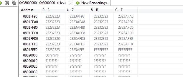

The last 2 bytes of FLASH cant be written?
I just was testing the bootloader, when it did not respond after writing the flash. Upon inspecting the memory, i found the last 2 bytes have not been written? (i guess the uC went to hard fault or something)
It should not be this way?

My bootloader. I write a file to it, that fills the remaining flash. If i write the FLASH only until 1FFF5 it seems to be fine.

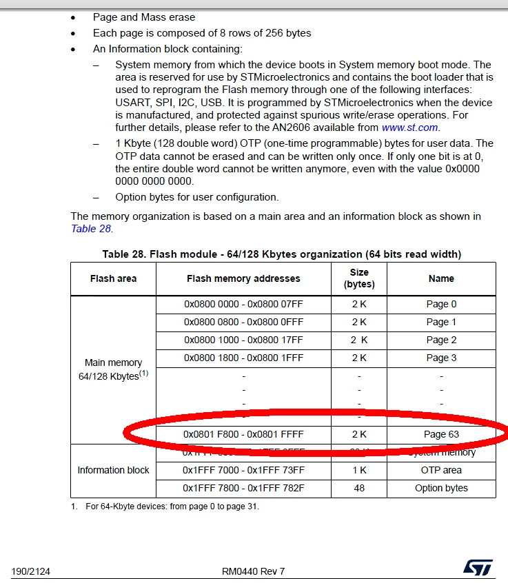

you need to check how your programming algorithm is implemented if writing 64-bit at a time or  a row  of 32 double words . Also if you are reading next bytes or words and in particular while cache and prefetch is active of the flash as it may read an extra byte ( not existing ) by cache / Prefetch line size even not wanted by CPU as speculation . And so hitting a not existing memory to read .

Two words... my bad.
It failed when writing the last 2 words that you can see on the picture (FFF0 - FFF7) which were written anyway). When i write the same, but without the last two bytes, it works without error.

Ok, so you've described the nature of the failure multiple times, but not presented any code that illustrates you're failed approach. If you think there's a Hard Fault, that's not hard to confirm or not..
You'd get a Hard Fault if you attempt to read or write beyond the scope of the memory.
Perhaps instrument your code, so it provides output about what's happening, and how it's writing 64-bit aligned double words to the memory.
