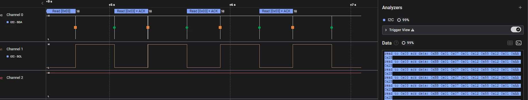

I am using STM32G050 and I also tried with STM32L476. I am transmitting data as an I2C Slave using STM-HAL. However, when I use HAL_I2C_EnableListen_IT, the transmission is an error. I can't read values and see the logic analyzer. HAL_I2C_DisableListen_IT allows successful data transmission. I am trying to understand the underlying reasons for this behavior. Why I can't transmit values?

You're not using the library according to the instructions. Don't call HAL_I2C_EnableListen_IT when you're using blocking transfer functions.
 *** Polling mode IO operation ***
 (+) Transmit in master mode an amount of data in blocking mode using @ref HAL_I2C_Master_Transmit()
 (+) Receive in master mode an amount of data in blocking mode using @ref HAL_I2C_Master_Receive()
 (+) Transmit in slave mode an amount of data in blocking mode using @ref HAL_I2C_Slave_Transmit()
 (+) Receive in slave mode an amount of data in blocking mode using @ref HAL_I2C_Slave_Receive()

When I transmit it like this  I can't transmit it again
HAL_I2C_EnableListen_IT(&hi2c2);
while (1) {
HAL_I2C_Slave_Transmit_IT(&hi2c2, packed, 10);
HAL_Delay(300);
