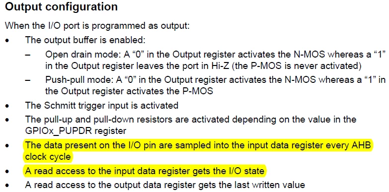

    It is not true. If a pin is configured as open-drain output and its ODR bit value is 1, it may be pulled down externally. Then its IDR bit is 0, but ODR bit still is 1. So, HAL_GPIO_ReadPin will return 0 while output state is 1.
    waclawek.jan
    January 17, 2020
    Well spotted, @hdmi87​ , even if this is a rather old thread, it's always good to correct a mistake.
    It appears that there's no function in Cube/HAL to read GPIO_ODR, it appears that the pin-toggling function is the only one which mentions ODR at all.
    OTOH, reading back ODR has a relatively rare usage. Cube/HAL, as inevitably every "library" does, implements only a subset of possible functionality, and of course that subset is based on the "most often used" functionality. I'd leave this to simply reading the register.

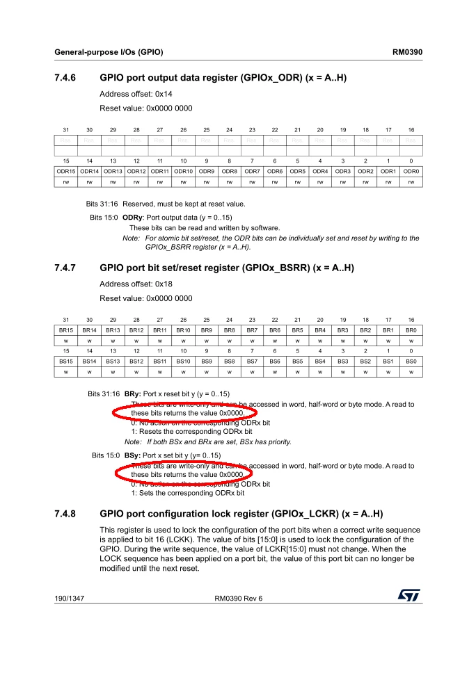

    If you just want to read back what you wrote to the pin, you can check whether GPIOx->BSRR is GPIO_PIN_RESET or GPIO_PIN_SET.
    waclawek.jan
    August 20, 2022
    Have you actually tried this?
    GPIOx_BSRR are write-only and read-as-zero.
    0693W00000QO7yeQAD.pngTo find out the state of output register, read, well, the output register, i.e. GPIOx_ODR.
