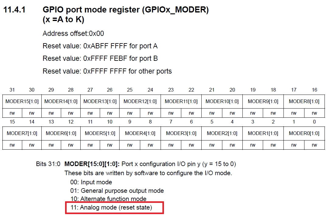

Dec 27, 2024 8:07 AM UTC
Sorry I didn't understand your last question.
After reset it's set to Analog input and it's in high impedance state (from RM0433):

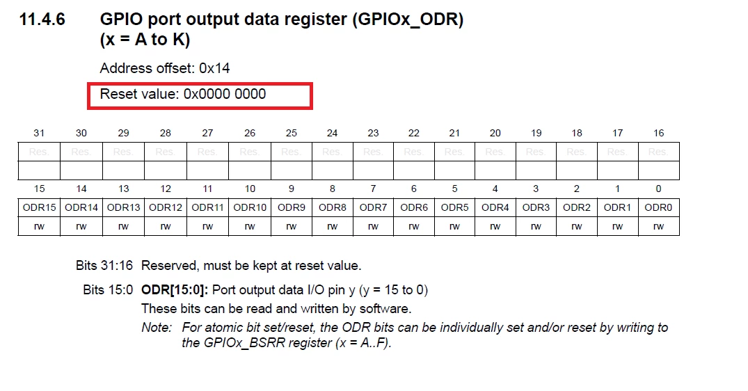

Dec 27, 2024 7:55 AM UTC
After reset it's analog input:
After reset the output is normally set to 0:
If you need to set it at a specific value on the initialization stage, set the value of the pin on ODR or BSRR register then configure the GPIO as output.

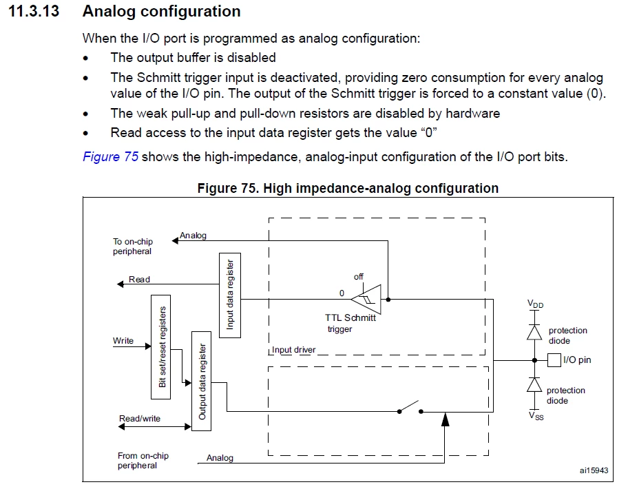

Dec 27, 2024 7:57 AM UTC
Thank you for your answer. I see, analog input!
Is it floating as an electric potential?
mƎALLEm
mƎALLEmBest answer
