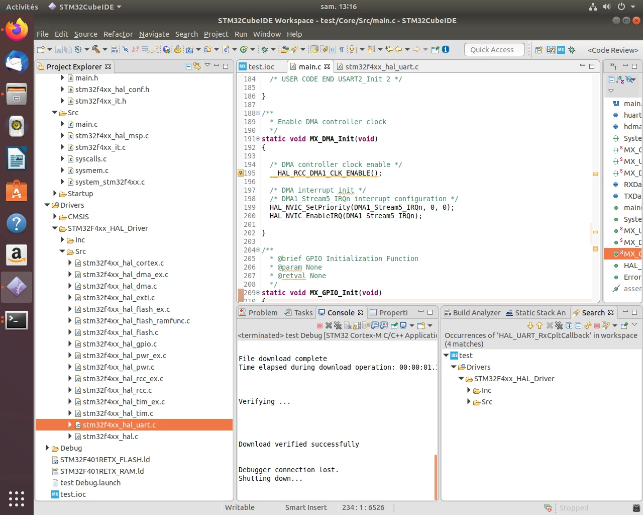

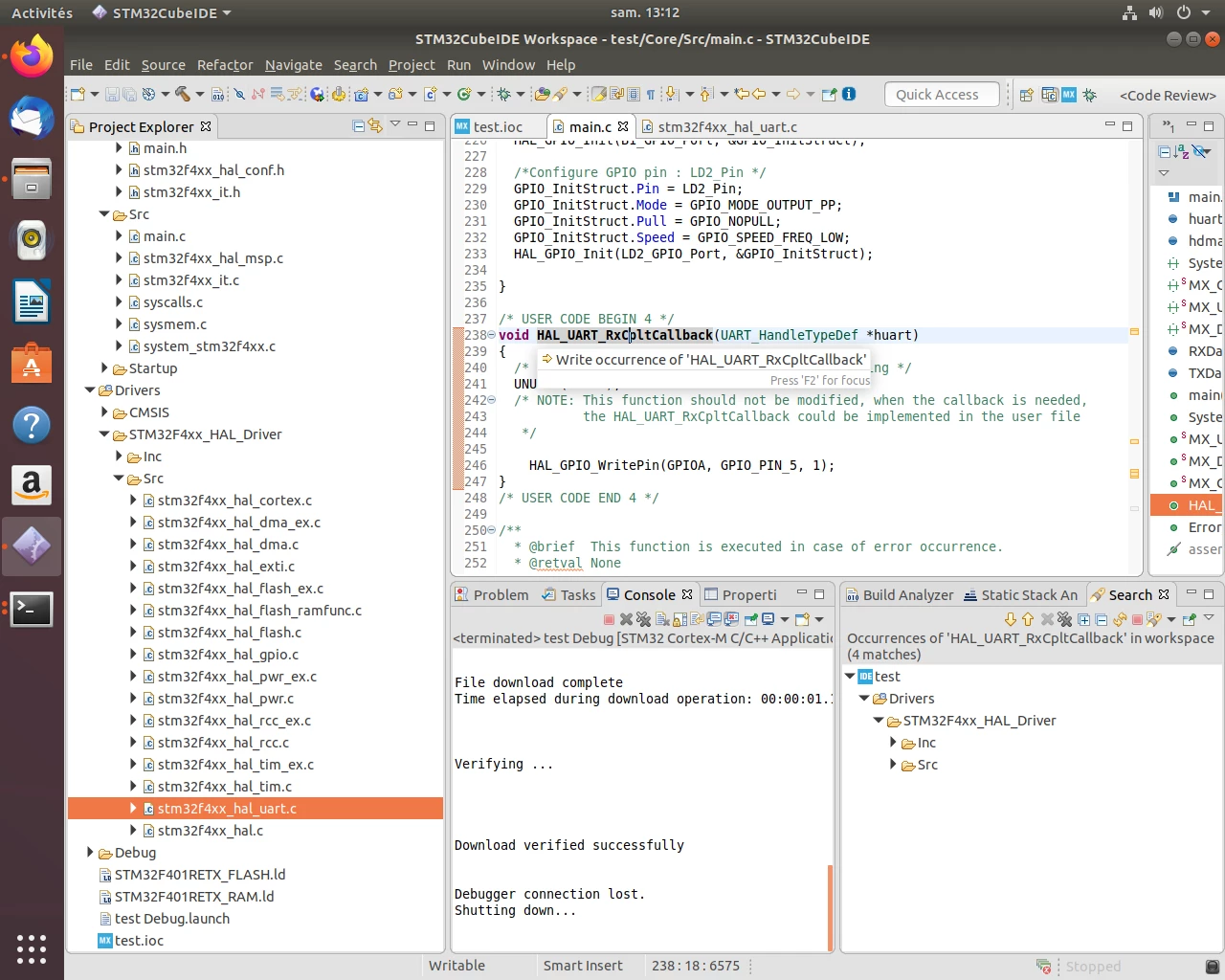

EDIT:
I know the issue now! The function is not declared yet. How can I declare that function so DMA knows that it exist?
/* USER CODE BEGIN 4 */
void HAL_UART_RxCpltCallback(UART_HandleTypeDef *huart)
 /* Prevent unused argument(s) compilation warning */
 UNUSED(huart);
 /* NOTE: This function should not be modified, when the callback is needed,
 the HAL_UART_RxCpltCallback could be implemented in the user file
	HAL_GPIO_WritePin(GPIOA, GPIO_PIN_5, 1); // Nothing happens here
/* USER CODE END 4 */
 The function is avaiable in stm32f4xx_hal_uart.c file.
 * @brief Rx Transfer completed callbacks.
 * @param huart Pointer to a UART_HandleTypeDef structure that contains
 * the configuration information for the specified UART module.
 * @retval None
__weak void HAL_UART_RxCpltCallback(UART_HandleTypeDef *huart)
 UNUSED(huart);
But if I hover the mouse over the function it looks like this
I'm also got some weird errors on DMA C-code. These errors says Missing ';'
