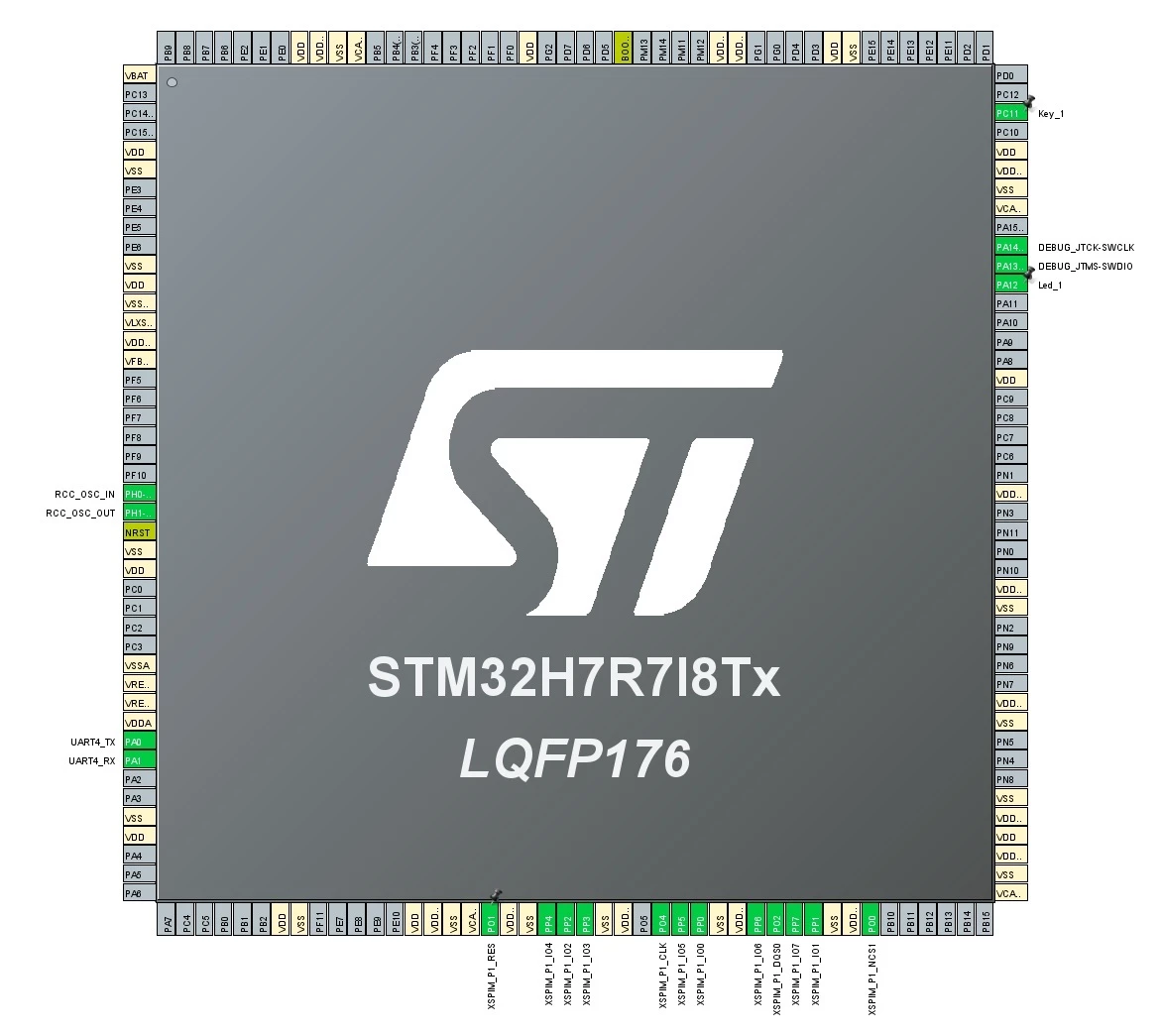

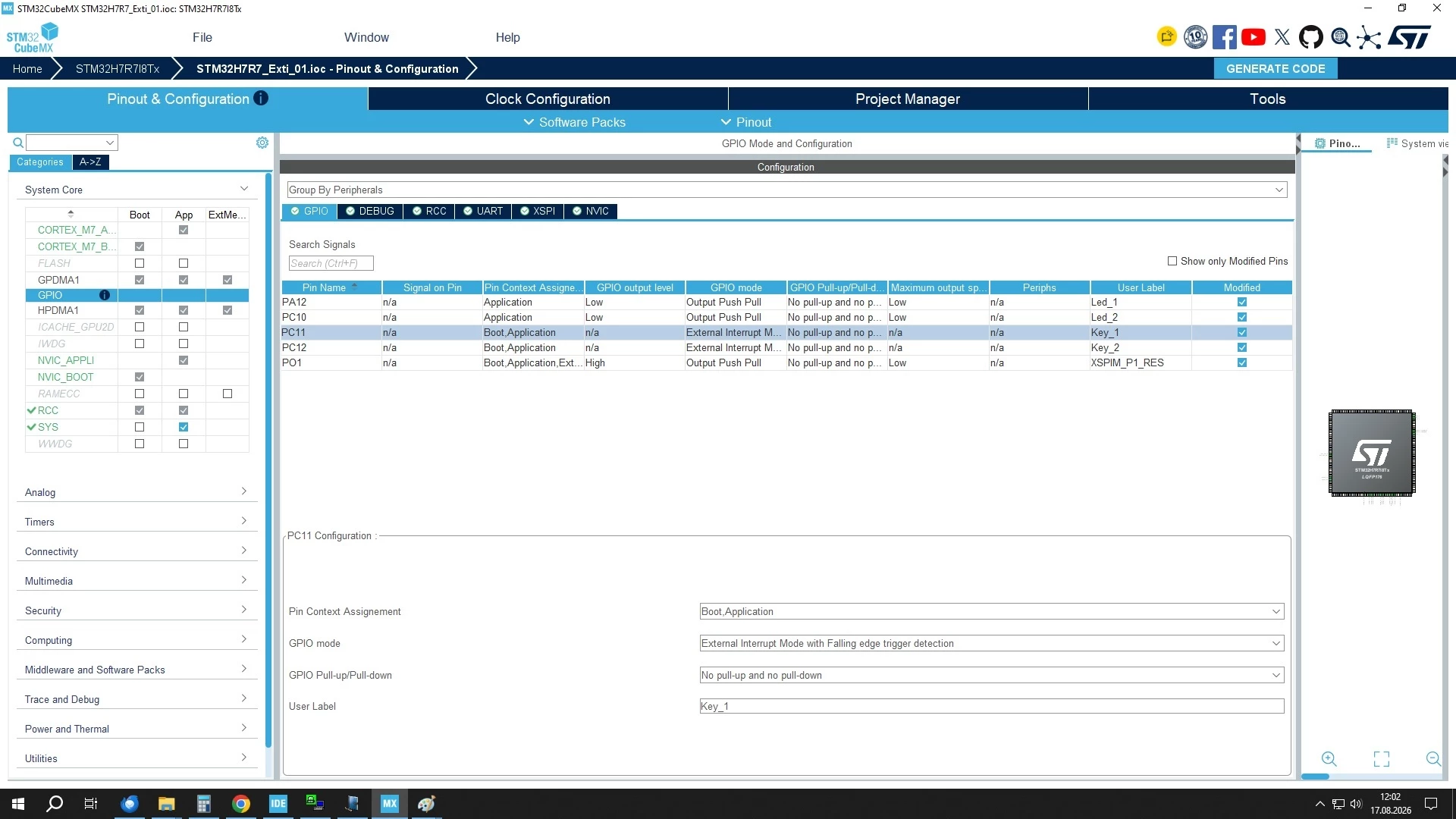

I'm trying to get the simplest example of triggering the EXTI interrupt on an STM32H7R7I8T6. I've run this thousands of times on other H7 series MCUs and never had any problems. I have a button and an LED connected to the MCU as shown in the diagram.
Pin PC11 configured as below:

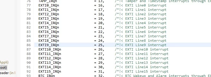

HAL_NVIC_SetPriority(EXTI11_IRQn, 0, 0);
HAL_NVIC_EnableIRQ(EXTI11_IRQn);

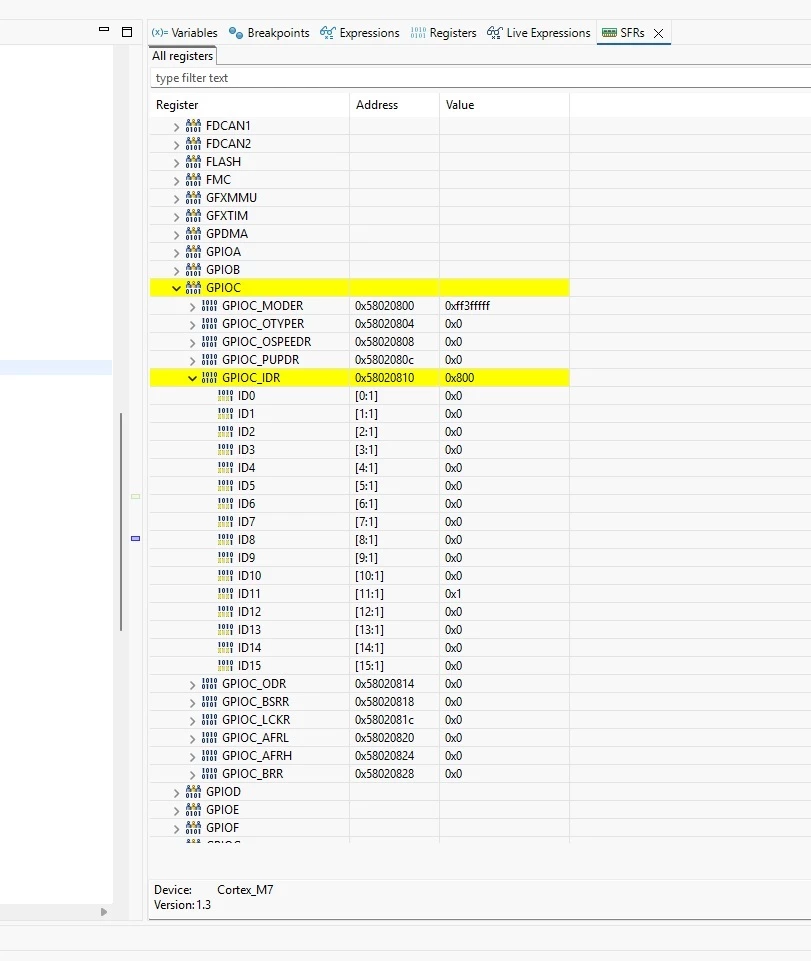

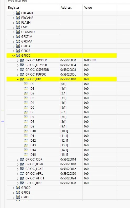

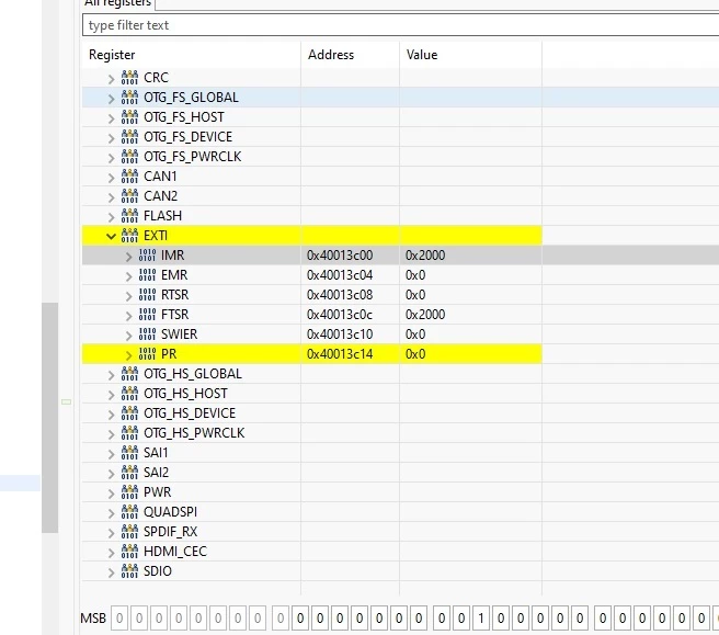

While debugging, I can see that the registers respond correctly to pressing and releasing the button:
When the button is pressed.
When the button is released.

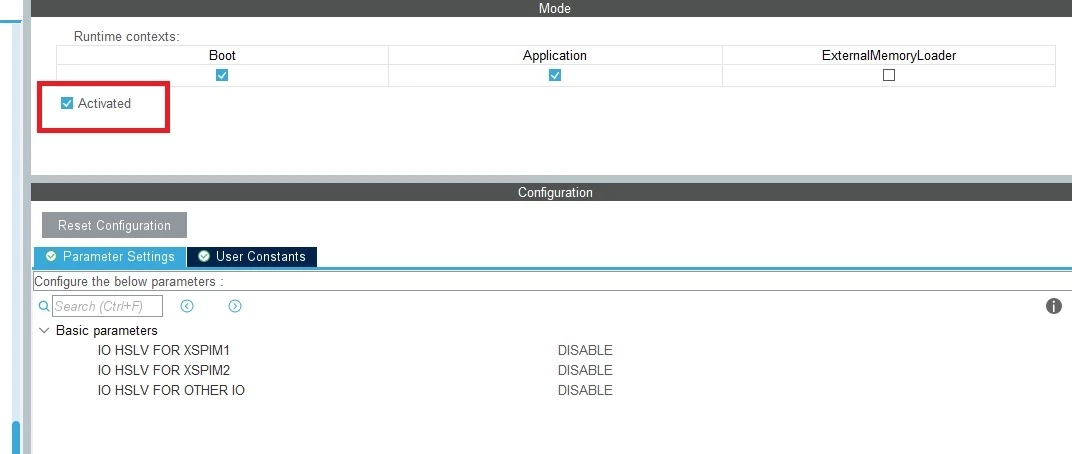

I tried reconnecting the key to different pins. Same result. The main loop definitely works. Interrupts are enabled... I tried with different priorities. The EXTI handler isn't called. I'm using the latest STM32CubeIde and STM32CubeMX. The project is attached.

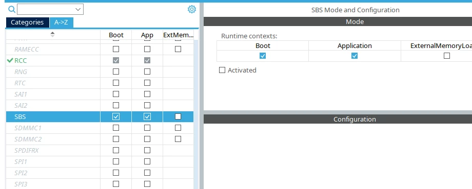

if sbs setting has effect, set in Cube:
...should do it.

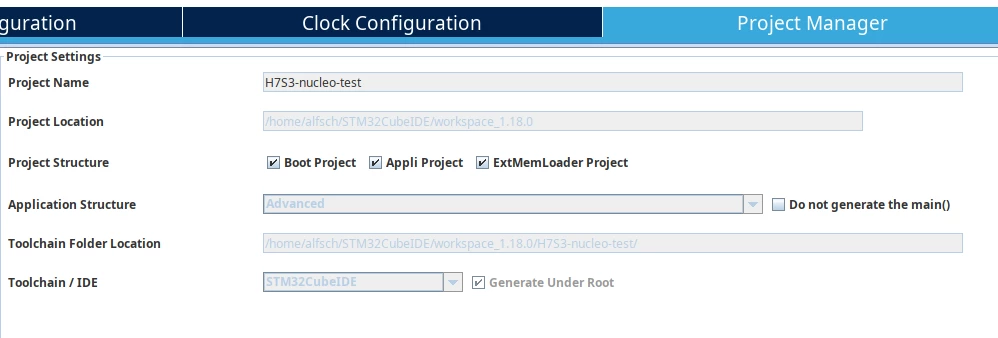

ok..just whats different here from my generated code :
the project setting in Cube : (i am on Linux system)
...under root !?   I would try it… but i dont know it has effect or not here.
ProcekAuthor
Aug 17, 2026 9:13 AM UTC
I tried that too.

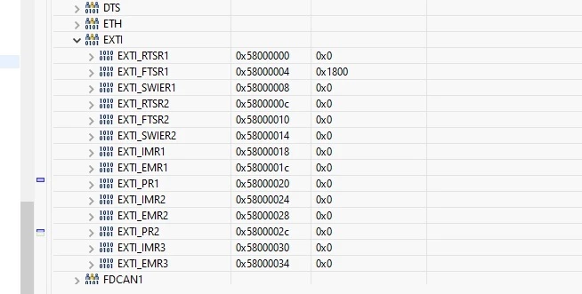

This is the EXTI register in the STM32F446. The IMR register is set in it.
For some reason the STM32H7R7 doesn't do this and this is probably the reason.

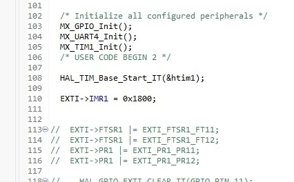

ProcekAuthor
Aug 17, 2026 9:28 AM UTC
I set the register manually.
And the IMR1 register is still set to zero. I don't understand this.

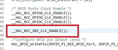

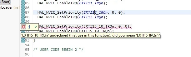

try: ena SBS clk + exti call ...15_10
_HAL_RCC_SBS_CLK_ENABLE();
GPIO_InitStruct.Pin = GPIO_PIN_11;
GPIO_InitStruct.Mode = GPIO_MODE_IT_FALLING;
HAL_GPIO_Init(GPIOC, &GPIO_InitStruct);
/* EXTI interrupt init - Jetzt auf dem korrekten Gruppen-Vektor */
HAL_NVIC_SetPriority(EXTI15_10_IRQn, 0, 0);
HAL_NVIC_EnableIRQ(EXTI15_10_IRQn);
ProcekAuthor
Aug 17, 2026 10:01 AM UTC
This won't work.

  • just put the sbs clk enable  -- then ?

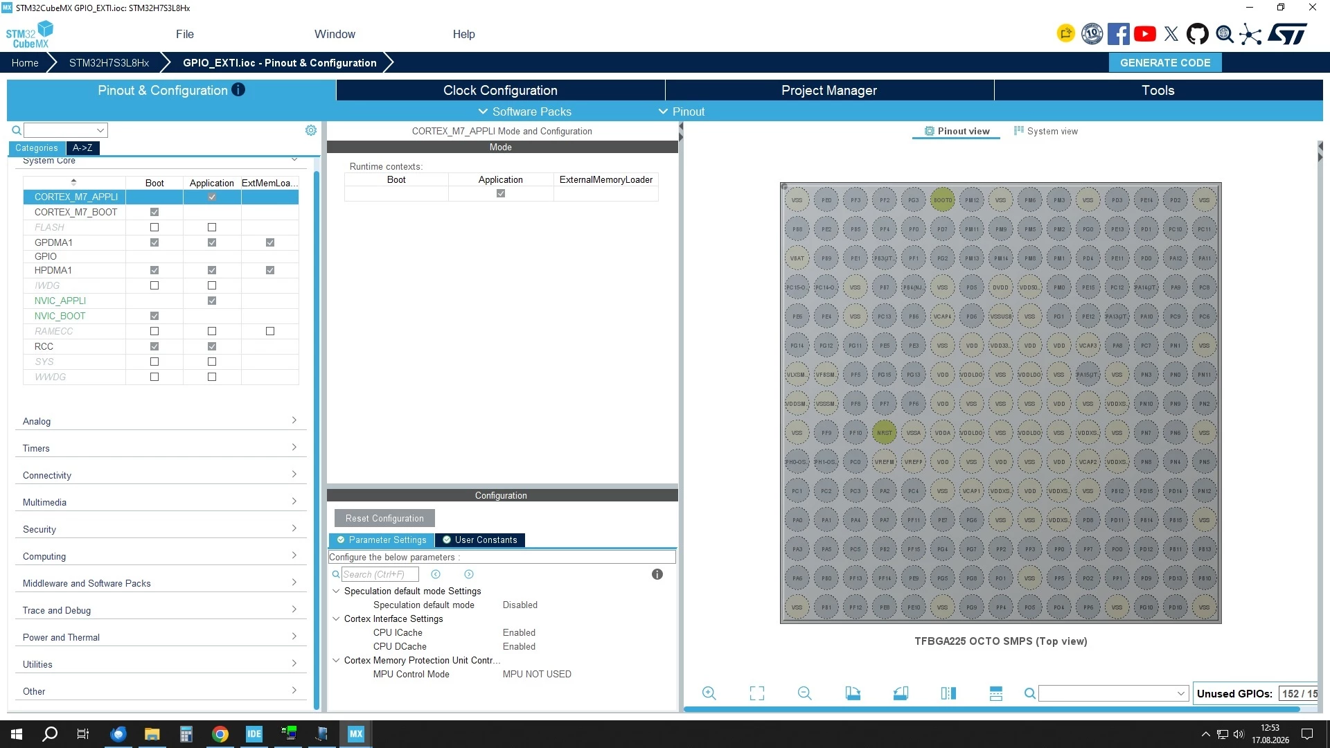

In debug mode, I've initialized the GPIO. But when I enter the "HAL_GPIO_Init(GPIOC, &GPIO_InitStruct);" instruction, the debugger redirects me to the HAL_GPIO_Init function in the BOOT section, not the Application section. And these pins aren't initialized in the Boot section. So I also added the configuration to the Boot section, but that didn't help either.
AScha.3
AScha.3Best answer
Aug 17, 2026 10:19 AM UTC
...should do it.
ProcekAuthor
Aug 17, 2026 11:31 AM UTC
I did this and it helped!!!! Thank you so much!!!

This option is probably for external memories powered by 1.8V?? I have an MX25LM51245G powered by 3.3V.
