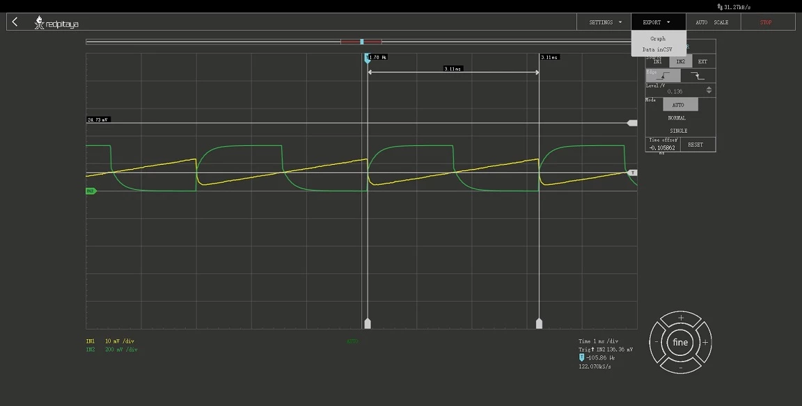

    Change the output signal self revert, see the waveform attached.
    void DMA1_Stream6_IRQHandler(void)////DAC DMA DMA1_Stream6
    /* USER CODE BEGIN DMA2_Stream2_IRQn 0 */
    if(__HAL_DMA_GET_IT_SOURCE(&DMA_DAC_Handle, DMA_IT_HT)) { //Half transfer
    Dac_Event = !Dac_Event;
    HAL_DMA_IRQHandler(&DMA_DAC_Handle);
    return;
    if(__HAL_DMA_GET_IT_SOURCE(&DMA_DAC_Handle, DMA_IT_TC)) { //Full transfer not enter
    Dac_Event = 0;
    Yellow channel is the DAC output a SAW UP waveform,
    Green channel is the DMA interrupt test output waveform.

    You are right, my ADC DMA work with normal mode, it's means 1 transfer to end, but my DAC DMA work with circula mode.
    But the interrupt response is still strange, the DAC DMA produce twice interrupt, and it's Flag always shows half transfer.
    Whatever, I can initial a global varible to identify if the interrupt is half or full.
