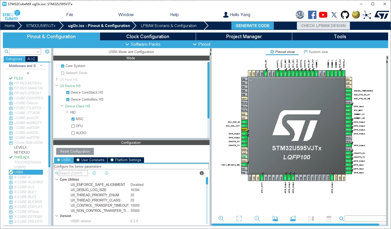

The divice is configured in High Speed Mode.  Yes, the logic stat of DEVLNSTS is not deterministic. Cube MX generate the code framework as the picture below. USBX and ThreadX are used in the software.

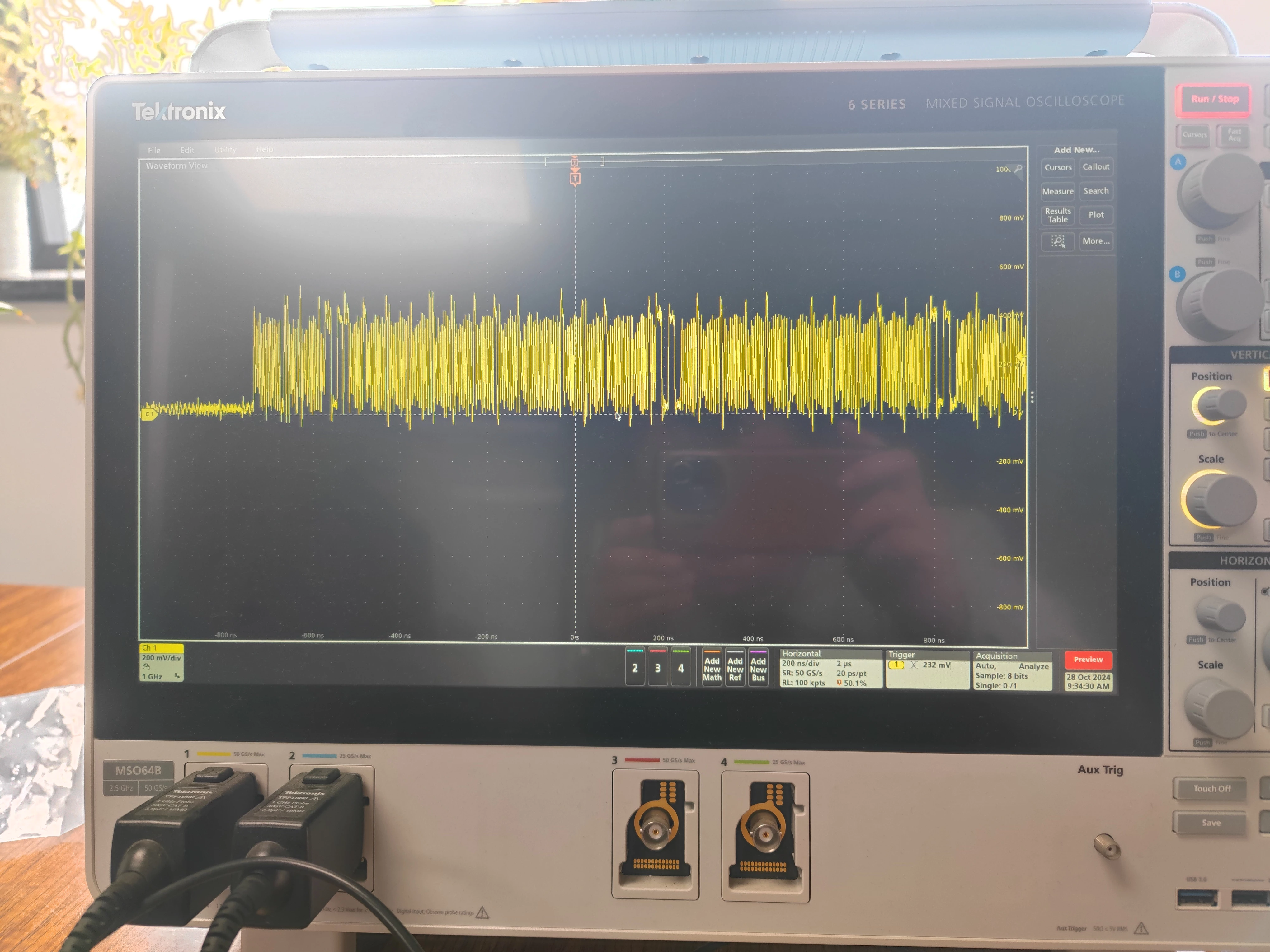

For the USB traffic, because the probe of the oscilloscape Tektronix MSO64 is 1GHz bandwidth, there might be some distortions about the signal measured.  The USB D+ waveform showes below during transmission.
Yang
