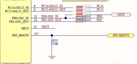

The code I wrote on the board Nucleo-L522ZE-Q has time interruption and controls the LED to flash. It is successful. After being applied to my own circuit board by ST-LINK , the time interruption cannot occur. I want to know why?

Ok, and what have you learned in the debugger, having stepped in from Reset_Handler ?
Check your design for BOOT0 pin/settings.
Check your HSE clock source is present and starts properly.​

I run it in debugging.​

Thank you. I solved it。BOOT0 pin must be set Low。I opened it。:face_with_tears_of_joy:
