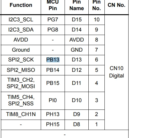

the built in led of stm32l4r9 discovery kit works plus led attached to other gpios don't work
i'm using stm32l4r9 discovery kit and the built in led of stm32l4r9 discovery kit works but led attached to other gpios don't work. no mater if i set or rest it.
kanuz_khanBest answer
Dec 19, 2023 6:40 AM UTC
On the documentation it states d13 as PB13?
the positive leg of the led is attached to 3.3v and the negative to d13 i just added a resistor equal to r5 on between ground and negative le and its working now

Hello @kanuz_khan, welcome to ST Community,
That's probably a wiring issue! Also, check if the GPIO you're using as configured correctly as output pins
Dec 18, 2023 1:29 PM UTC
i've checked the wiring it works fine when i attach it to vcc
mƎALLEm
Dec 18, 2023 1:24 PM UTC
Hello @kanuz_khan
Could you please specify which LEDs attached to other GPIOs you are talking about? LEDs you connected externally or what? which GPIOs? How did you connect the LEDs?
Please provide more details and if possible your schematics.
Thank you.
 i'm using ph4 and gpio_8

You need to have this config for PH4:
GPIO_InitStruct.Speed = GPIO_SPEED_LOW;
GPIO_InitStruct.Pin = GPIO_PIN_4;
HAL_GPIO_Init(GPIOH, &GPIO_InitStruct);
Dec 18, 2023 1:55 PM UTC
ph4 works perfectly fine its pd8 thats not working. thank you so much for helping out
mƎALLEm
Dec 18, 2023 2:09 PM UTC
Next time please be more specific on the issue .. Your problem description is confusing.
Now for PD8:
- Check the connections using continuity between the LED and GPIOD8.
- external_led_Pin: does it correspond to GPIO_PIN_8?
- external_led_GPIO_Port: does it correspond to GPIOD?
- HAL_GPIO_WritePin(external_led_GPIO_Port, external_led_Pin, GPIO_PIN_RESET); try to toggle it instead of writing a value. I suspect that the external LED is pulled down to GND and not pulled up to the VDD like Green LED.
