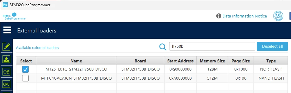

1. In CubeProgrammer, select the following External Loader:
MT25TL01G_STM32H750B-DISCO.stldr
> C:\Program Files\STMicroelectronics\STM32Cube\STM32CubeProgrammer\bin\ExternalLoader
> The Page Size is 0x1000, but according to the Datasheet, I believe the correct value should be 0x100.nonoriri_0-1717231567257.png

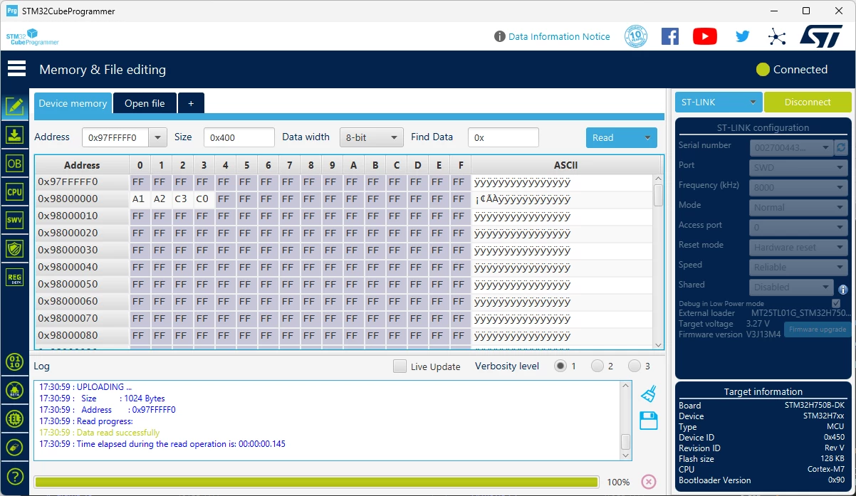

4. In the Memory & File editing menu, specify the address 0x97FFFFF0 and read.
> Data is written at the 0x98000000 location.

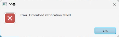

5. In the Erasing & Programming menu, select a 4-byte binary file and start programming.
Binary content: 0xF5E6D7C8
Start address: 0x98000000
> This time, "Error: Download verification failed" occurs.
6. In the Memory & File editing menu, specify the address 0x97FFFFF0 and read.
> The data at the 0x98000000 location is suspicious.
7. If you try to write a 4-byte binary to addresses like 0x98000004/0x98000008, it fails.
> This is the correct behavior.

Q1. Is the Page Size of 0x1000 incorrectly specified?
Q2. Why is it possible to write data to 0x98000000?

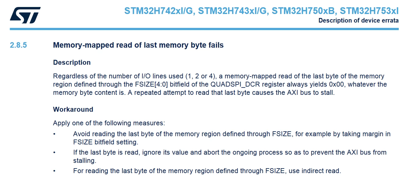

I think this is related to following thread.
https://community.st.com/t5/stm32-mcus-products/stm32h7-crashes-when-reading-the-last-bytes-from-a-memory-mapped/td-p/169513
https://community.st.com/t5/stm32-mcus-products/h7-quadspi-weirdness/m-p/258686
Also, the errata sheet ES0392 mentions the same problem.
Which is a better approach?
  1. FSize + 1
    • Allow overflow access to the flash when using STM32CubeProgrammer
  2. Do not change FSize
    • Do not write to the last 4 bytes
