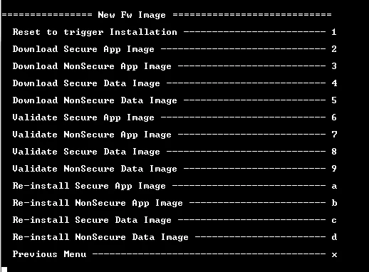

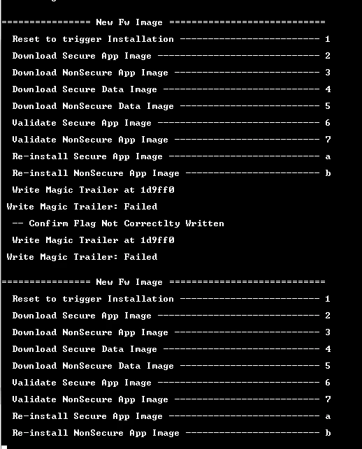

I am developing a procedure for updating the firmware.
For this procedure, I'm using TFM-Boot and TFM-Loader. In TFM Loader, I've included several features like image validation and re-install image functionality.
However, I've had various magic num-related errors. When i execute re-install image and validation of image
Please give me advice on how to solve this problem as I have also included a screenshot of the log file.

I'm using TFM-boot, TFM-Loader, and TFM-Application for firmware upgrades. I activated swap mode and double-checked that everything was functioning correctly. but i replaced TFM-Application with our created Application
As per our requirement, we require TFM-Boot, TFM-Loader and jump to our created application
below I mention the steps.
I've included the steps I take to integrate my own application below.
1. Create Project Name: Application[Enable TrustZone]
2. Change the .ld file of the secure and non-secure project[output.ld - added prebuild file in secure and non-secure project properties]
3. Change linker path in secure and non-secure project properties
4. Added Postbuild. sh in own application repo
5. Update NS address in secure-> main.c "#define VTOR_TABLE_NS_START_ADDR NS_CODE_START"
6. Added post-build. sh path in secure and non-secure project properties
7. Successful compile code
8. Generate sign with encrypted .bin file in Binary folder
9. Go to the local bootloader with a reset
10. Upload encrypted sign .bin through SBSFU_Loader
11. Reset Trigger
Outcome:
i am not able to successfully integrate our application.
LOG:
[INF] signature OK
[INF] Bootloader chain load address offset: 0x1a000
[INF] Jumping to the first image slot
so could you please advise me on how to integrate our project with TFM_Boot and TFM_Loader?
