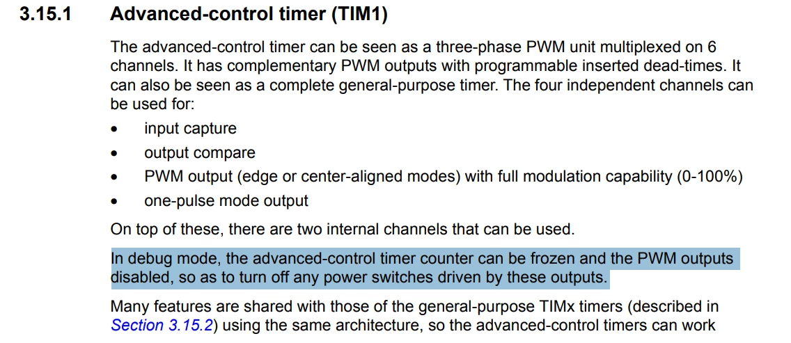

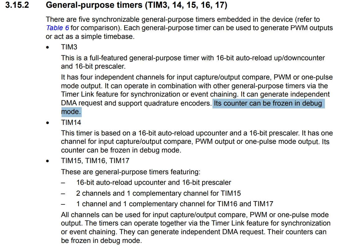

I have selected STM32G070RB MCU for my application, I need your guidance to get clarification on the the below points before finalizing the MCU and start hardware design.
Error in the calendar after one year with internal 32KHz crystal selected for RTC.
Can Li-ion battery connected to VBAT pin will provide power to MCU, when input power failure, to save the parameter to flash.
I have selected TIM1 for encoder and TIM14 for PWM output, can I use encoder and PWM functionality in debug mode. refer below image from data sheet.
The debugger you are using should have some setting to enable/disable the timer freeze during debugging break/single-stepping.  This feature is enabled/disabled through DBG_APB_FZx registers, see DBG chapter in Reference Manual.
You can use TIM1 for encoder and TIM14 for PWM while debugging, yes. They are independent. Freezing the counter during debugging is optional. Up to you.
