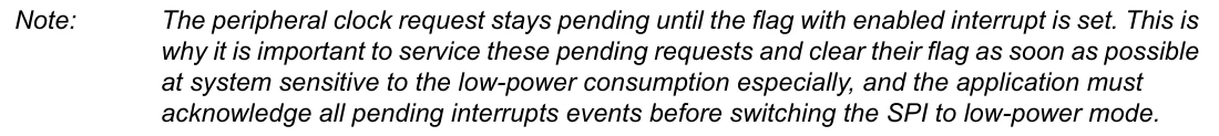

ok, this was super difficult to resolve and in the end I wrote a stand alone program to run on my board that did:
  1. Enable second alarm
  2. Do a spi dma operation
  3. (optionally) clear spi registers -- this is to test the incomplete clear
  4. enter stop mode (0, 1, or 2) waiting for second alarm
  5. attempt to write internal flash
Here’s what I found
 -- without fully clearing the spi registers (doing a complete shutdown), while the WFI worked, the core wasn’t actually in the low power state, and writing flash worked
-- with fully clearing the spi registers, the core entered the appropriate low power state and writing flash failed.
So, the spi issue, while not exactly a red herring, was causal only in that it blocked the low power state (btw, the documentation needs to address clearly what is required to enter a low power state).
In the end I had to explicitly restart the power mode and do some cleanup on flash (code follows).  This is, at best, under-documented in the reference manual.
Note: none of this diagnosis would have been possible without my Joulescope.  No amount of simply running code or staring at give the insight from actually measuring power levels and correlating them with specific I/O events

August 14, 2026
There is plenty of documentation saying how to enter low power modes and why it may not be working right. There are also examples for entering these states. Hard to say if this note in particular was the relevant one, seems likely. There’s also a few notes in the low-power section that seem relevant. It’s easy to just blame documentation but it’s more productive to enter these situations with the idea that maybe the answer is there and you’re the one missing it. The RM is 2870 pages. It’s reasonable and expected to miss stuff.
