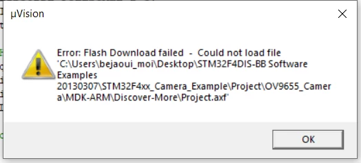

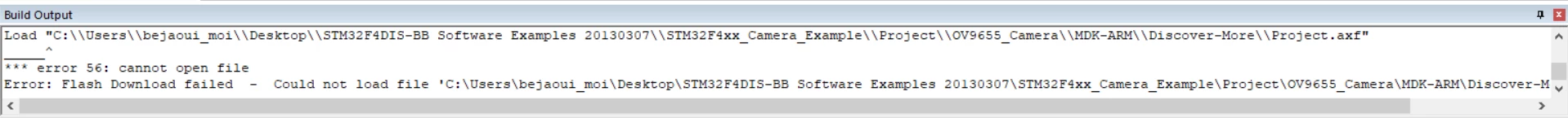

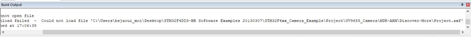

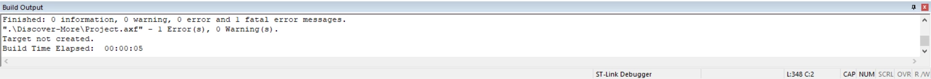

i build the code of "STM32F4DIS-BB Software Examples 20130307: STM32F4xx_Camera_Example" but it can't create the .axf file.
who had an idea?
Thanks.0690X00000ArrslQAB.png0690X00000ArrsgQAB.png0690X00000ArrsbQAB.png0690X00000ArrsRQAR.png

The build has a FATAL​, try looking at that as nothing downstream is going to work. You can't debug things that don't build.

yes, i have to know why it can not build, it's the official driver from https://www.element14.com/community/docs/DOC-51670/l/stm32f4dis-bb-discover-more-software-examples

.\Discover-More\Project.axf: error: L6050U: The code size of this image (33952 bytes) exceeds the maximum allowed for this version of the linker.

Pavel A.Best answer
Nov 9, 2019 6:34 PM UTC
Yep. The free Keil license allows up to 32KB.
Try to reduce the size a little (enable size optimization, remove some unused code/data)
