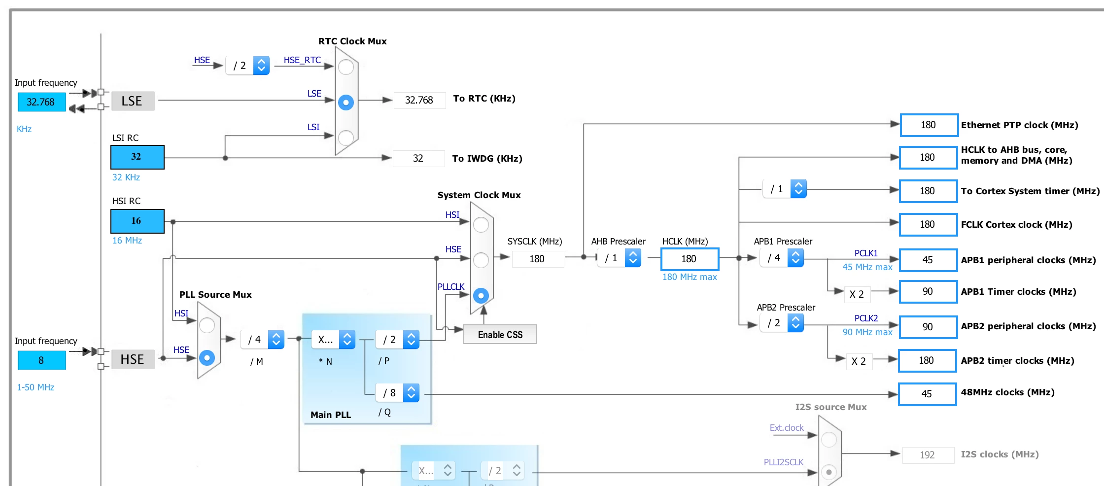

I'm using an STM32F429ZI Nucleo-144 board with CubeMX, enabled FreeRTOS, LWIP, USARTs, IWDG, RTC. The HSE clock source is the on-panel ST-Link 8MHz, the LSE clock source is the on-board 32.768 kHz crystal oscillator.
Since I have recently upgraded to latest cube package version (upgraded FreeRTOS, HAL, CMSIS, Cube libs) I realized that the time base of the panel just got speedy. If I use it to calculate time (and not the RTC), I experience about a 20% overspeed.
I tried using bothe the Systick and Timer1 to provide the timebase source, with the same outcome.
Additional information is that I power the board from external 12V.
Any ideas why this symptoms may come up?
Here are the clock configs from Cube:
#systick-timer #stm32-f4 #stme32-cube

To be honest I have not done any calculation, I have used CubeMX to configure the clocks. The system core clock is 180 MHz. And as I mentioned these symptoms raised since I have upgraded HAL, CMSIS, etc. libraries.

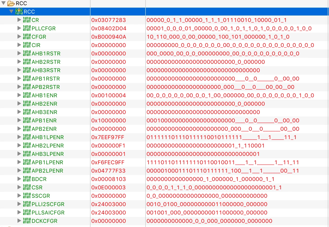

I have configured the MCO with prescaler to output 2 MHz clocked from the system clock, also measured with a scope and found it to be precisely at the 2 MHz.
Also captured RCC register contents (see screenshot).
An additional finding: when the board starts up it measures time correctly up until about 1-2 hours. Then something goes wrong and the timing gets speedy. I have not yet been able to measrure MCO when the problem occurs, once I've done that I will publish my findings. Also I will start logging out the contents of registers to identify if something is changing after this 1-2 hours period.
Also one more info - the core clock is set to 180 MHz (power scale 1, overdrive enabled). Not sure if this is important or not.
