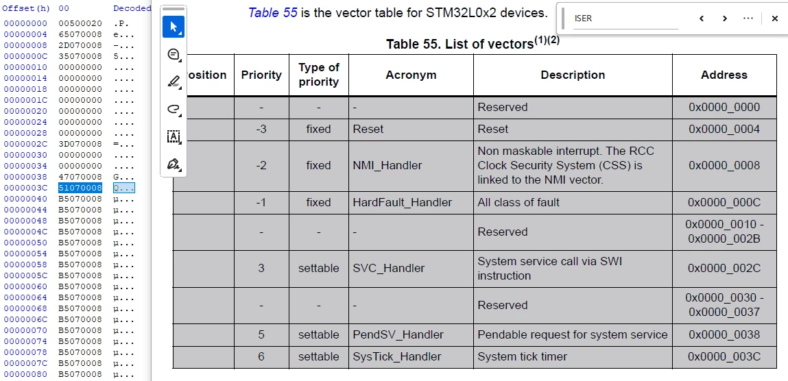

Hello, I have a problem with SysTick interrupt on STM32L072KZUX.
I am using the latest version of STM32CubeIDE + the latest package for my MCU - FW_L0 1.12.3. An absolutely clean project, which was created in IDE and flashed into the device using ST-Link, starts up fine after flashing, but when the SysTick count reaches overflow and an interrupt should be called, for some reason the program goes to the wrong address (PC = 0x1ff00dd0), of course the interrupt handler itself is declared and there is a pointer to the function in the assembler file. Moreover, it does not matter which framework to use: LL or HAL. I checked the vector table both in the firmware image and in the microcontroller memory, all addresses are correct. Moreover, it does not matter how to use it. We checked it on 2 chips from the same batch, a similar program flashed into NUCLEO-L073RZ works correctly.

Best answer by kuzdmin
The problem was in the connected BOOT0 pin, which caused interrupts to call the handler from system memory.
1 reply
kuzdminAuthorBest answer
July 3, 2025
