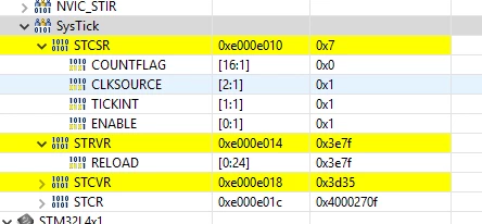

When debugging the project I noticed that Systick interrupt is not getting called. Systick STK_VAL register is changing, and STL_CTRL register COUNTFLAG bit is set. Interrupt in stm32g4xx_it.c void SysTick_Handler(void) is never called as a result uwTick is never incremented and HAL_Delay() function hung up because of this.

Is the NVIC SysTick interrupt enabled? Is TICKINT set?
Are interrupts disabled in general?

I am having the same issue with STM32L431CBT6. I am using STM IDE cube 1.14 and STlink-V3.
I checked the system tick. it is running.
The SysTick_Handler(void) is never getting called.

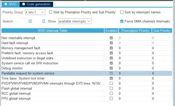

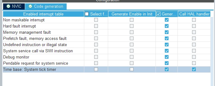

I'm sharing my solution in my case. Using Stm32 Cube IDE 1.12.1 and Nucleo G491RE. Systick interrupt stopped to work after I switched from HAL to LL version in Project Manager -> Advanced Settings for all peripherals including RCC. Later, during the investigation of this problem, I found that CubeMX dialog shows tooltip stating that system interrupts are always allowed, not need to be allowed. But, after I add following line in User code zone, systick interrupt starts to work:
LL_SYSTICK_EnableIT();
My issue solved.

waclawek.jan
May 4, 2023
This is slightly misleading.
Interrupts are generally enabled at two places: at the source (here: in the Systick module), and in NVIC.
System interrupts indeed don't need to be enabled in NVIC, but they still need to be enabled at the source (except HardFault and NMI (although sources of NMI may still need enabling)).
Corollary is, don't blindly trust the clicking interfaces. Mcu works out of the registers, not out of whatever you've clicked, not even out of C source code nor libraries.
