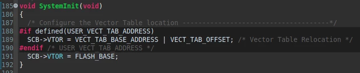

According with the Eclipse IDE the code isn't active:
The USER_VECT_TAB_ADDRESS constant is neither defined for the CB nor the RB variants. However, it worked as a charm for the RB one.

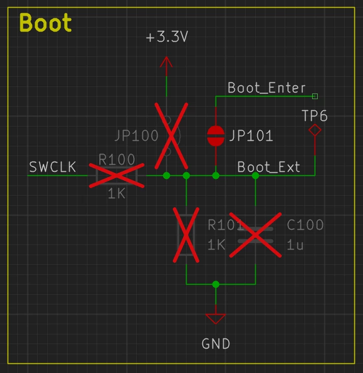

For the sake of completness let me show you my schematic:

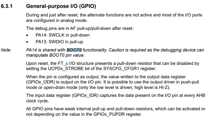

UM_6.3.1 says that SWCLK has a pull-down resistor, so I guess that, for debugging purposes, I don't need neither R100 nor R101:
