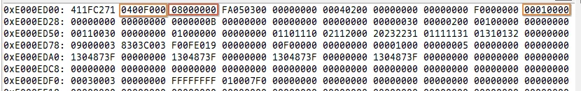

systick handler keep pending on stm32h7 board.
I made a project with stm32h7 board, and use pemicro multlink to debug it under keil. I found it keep in systick handler pending but no active.
I checked systick module register as:
the counter is changed.
and then I checked SCB releate registers as
and the interrupt handler addr is as
matched with vector config as:
I don't know where is wrong ?

Only so many reasons why an interrupt is not happening. Go down the list and verify them all:
  • Interrupts need to be enabled globally (they are by default, use __enable_irq()).
  • SysTick interrupt needs to be enabled (in SysTick->CTRL)
  • Execution cannot be in an equal or higher priority interrupt (print out SCB registers).
Viewing values in a register viewer (e.g. the SFR window in STM32CubeIDE) will be easier to navigate than viewing raw memory and translating.

1. I have checked SysTick->CTRL = 0X7 so SysTick interrupt has beed enabled.
2. Execution cannot be in an equal or higher priority interrupt (print out SCB registers)  I wonder which register do you mean ? and I have print these registers in the picture below.
3. Interrupts need to be enabled globally (they are by default, use __enable_irq()) I will check this later with PRIMASK , FAULTMASK, BASEPRI..
September 6, 2024
Mainly SCB->ICSR, which contains VECTACTIVE. Should also get this information by looking at the call stack.
