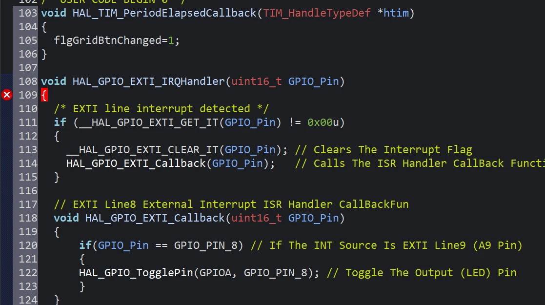

My code was compiling fine, then I turned on the Doxygen setting in preferences. Now i get lots of errors and warnings. My function prototypes say used but never defined. My functions say invalid storage class. I can't find what is broken. I turned off doxygen setting and removed alll the comments it added, no luck. Help?

    The problem is the error is obscure:
    The line
    static void MX_I2C1_Init(void) {...}
    gives the error 'invalid storage class for function 'MX_I2C1_Init' but the line is generated by cube mx and looks fine. This seems like something higher up in the code is broken but I cannot find it.

    Sounds like you're missing a bracket somewhere. Post the file.

    You're missing a closing brace on the HAL_GPIO_EXTI_IRQHandler function.
    /* USER CODE BEGIN 0 */
    void HAL_TIM_PeriodElapsedCallback(TIM_HandleTypeDef *htim) {
     flgGridBtnChanged = 1;
    void HAL_GPIO_EXTI_IRQHandler(uint16_t GPIO_Pin) {
     /* EXTI line interrupt detected */
     if (__HAL_GPIO_EXTI_GET_IT(GPIO_Pin) != 0x00u) {
     __HAL_GPIO_EXTI_CLEAR_IT(GPIO_Pin); // Clears The Interrupt Flag
     HAL_GPIO_EXTI_Callback(GPIO_Pin); // Calls The ISR Handler CallBack Function
     // EXTI Line8 External Interrupt ISR Handler CallBackFun
     void HAL_GPIO_EXTI_Callback(uint16_t GPIO_Pin) {
     if (GPIO_Pin == GPIO_PIN_8) // If The INT Source Is EXTI Line9 (A9 Pin)
     HAL_GPIO_TogglePin(GPIOA, GPIO_PIN_8); // Toggle The Output (LED) Pin
     /* USER CODE END 0 */
    Brother Theo
    March 16, 2022
    That did it! Thanks your your help!

    Personally dislike opening bracket on a separate line, but standardized formatting in C is never going to happen since it hasn't already. But since HAL uses it, I'll use it if editing HAL files.
    Two IDEs I use, CLion and STM32CubeIDE, both give warnings on mismatched brackets. TI CCS sort of gives a warning, but not really. STM32CubeIDE is particularly aggressive about it with a big red X.

    Is there a particular setting to get this red cross on missing bracket? For me CubeIDE does not do this.
    March 17, 2022
    To the best of my knowledge, my settings are default apart from the color scheme. I looked around for a few minutes and couldn’t locate where/if it can be enabled. Google search wasn’t helpful either. Shrug.
