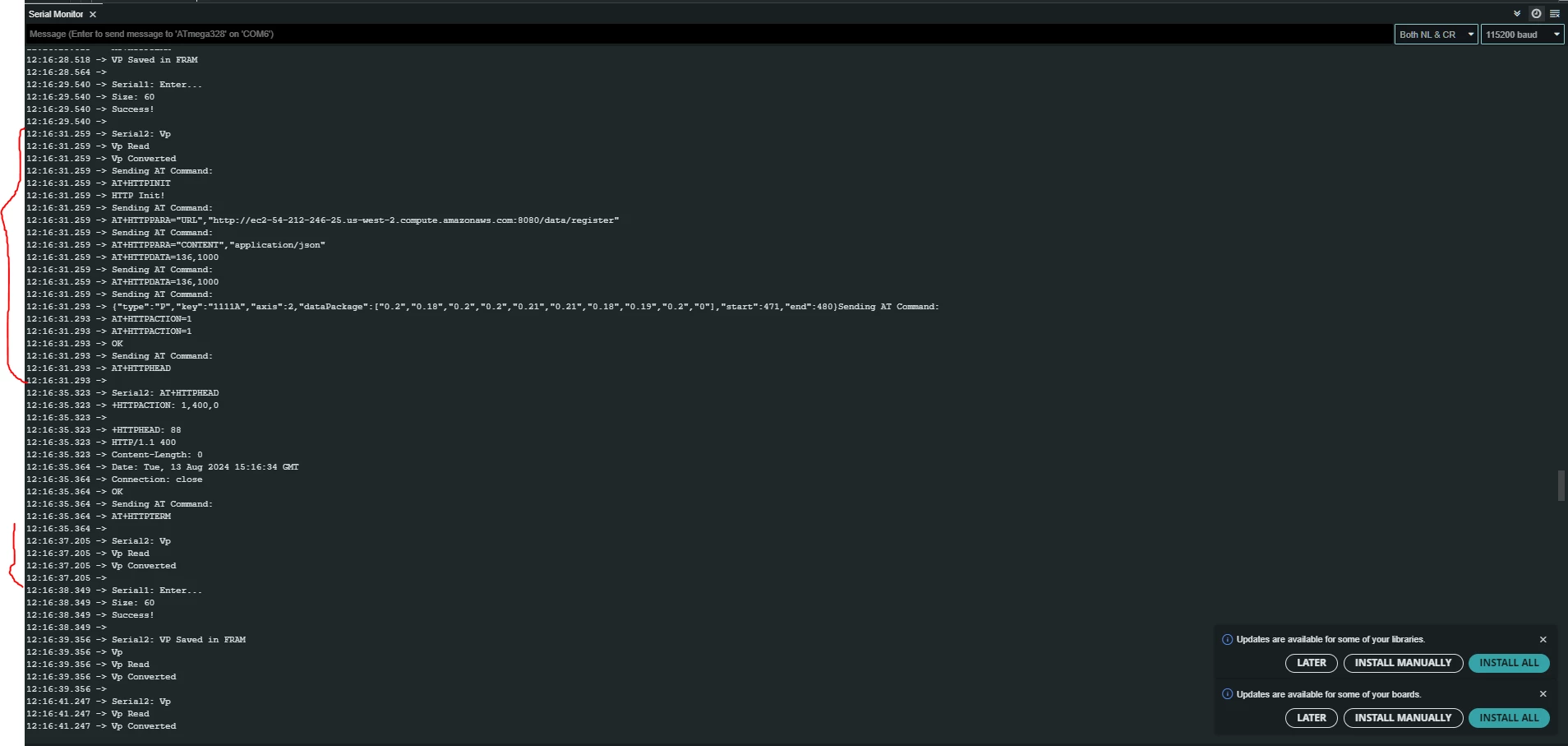

Well, I'm developing a system for reading sensors and sending them to a server.
I'm using a GSM LTE module to do this sending. At first it worked well, but after a while the system stopped sending messages to the server.
We can see this clearly in the images below.

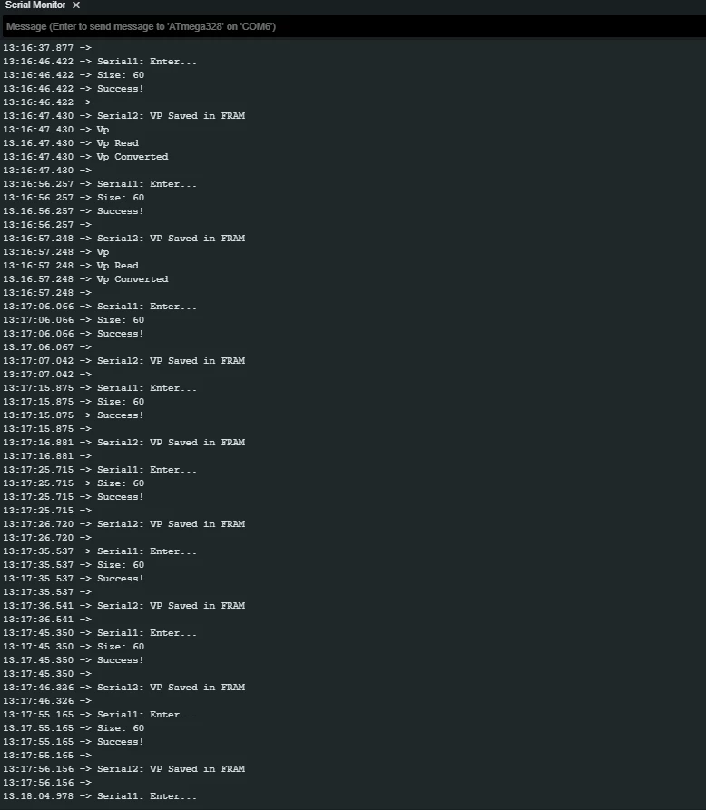

 In this first image we see a post request being made by the GSM after information from the sensor arrives, but after a while it starts behaving like in the second image.
Here the information is arriving, it starts the sending procedure as shown by the Vp logs, but crashes when sending the Json information, then starts again and crashes and so on.
My firmware does the following, it reads data from lora, this data can be either a struct called VibrationPackage or one called DataPackage, they are identified and stored in the external FRAM memory and also a char is stored in an array of indices in the internal memory.
This array is used for the commands in the execution loop to know which is the next struct to be sent to the server.
The program reads the first FRAM address, knowing which struct it is from the array of indices, takes the information, transforms it into JSON, sends it and clears the item from the FRAM.

Why am I suddenly getting this behavior?

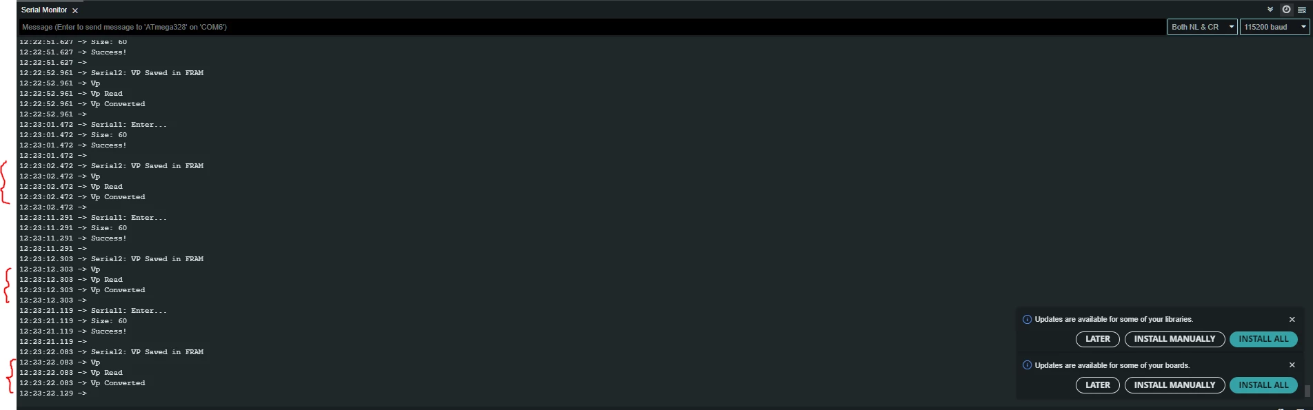

Note that the system didn't restart, but skipped the behavior of sending the json, without even sending the AT command attempt messages to the GSM.
sssad.PNGEdit: After another period of time, he also stops his second behavior.
