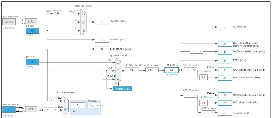

After analysis, the problem comes from the initialization of the CPU clock. In our application, we use an external oscillator 8Mhz and configure the PLL to have SYSCLK=24MHz. (PREDIV1 ="/2" and PLLMUL="x6")
On the VC and VD the SystemCoreClock returns =24MHz, but on the VE SystemCoreClock returns =48MHz however it is not possible on this MCU: the max is 24MHz so that's why it does not work.
I checked the RCC registers after the same initialization phase:
- On the VC and VD ref, I have CFGR= 0x0013000A CFGR2=0x00000001
- On the VE ref, I have CFGR= 0x0011000A CFGR2=0x00000000
it seems that the writing to the CFGR2/PREDIV1 bits or PLLXTPRE bit doesn’t work on the 100VE ref. Why?
I am very surprise of this behavior because these 3 MCUs are from the same family: STM312F1 Value Line, so the same core and same peripherals, only the flash and ram size should be different.
To be sure, I tried creating a new project with the latest version of the ST library to verify the problem doesn’t come from my old versions of files. I used STMCubeMX and created a new empty project for the STM32F100VE with the same clock configuration but no changes, it also doesn’t works. I have the same observations CFGR2/PREDIV1 bits or PLLXTPRE bit are not written.
Do you have any idea why I have this behavior and if this issue is already known on this MCU reference?
Do you have any idea how to configure the RCC registers to have compatibility between these 3 references?
