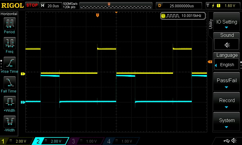

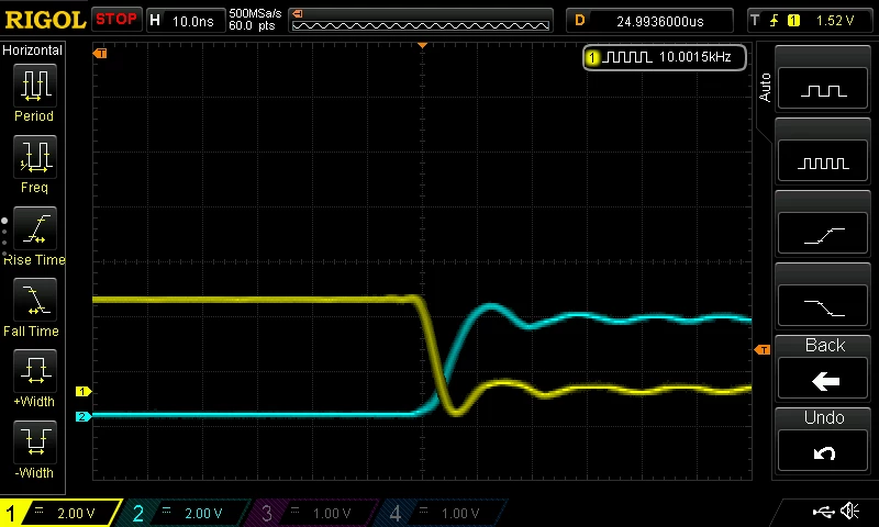

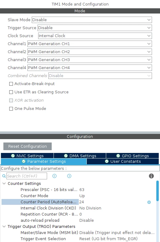

Hi, just for fun...
i tried on an old F103 (blue pill) , most simple way to do this with one timer:
switch out/channel/compare with UI , timer update (=end of cycle), in round robin way;
so just on 2 ch shown:   100us loop, 25us / channel ON time.
here the crossover at 10ns /div (just with probes, that were at the scope, about 60MHz typ. )
F103 at 64MHz core; tim1 set:
the "program" :)

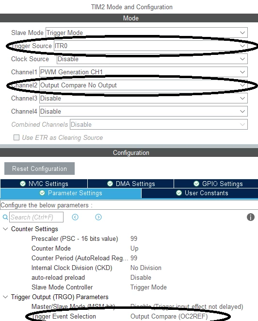

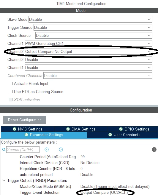

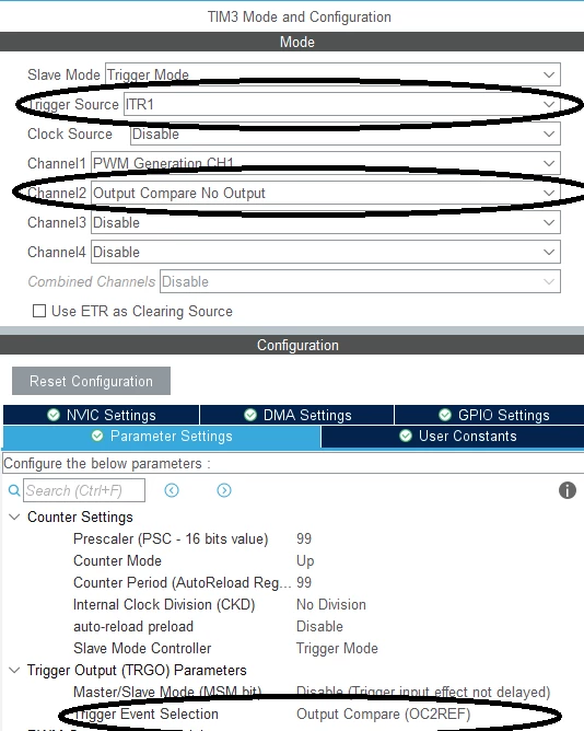

erincyldzAuthor
December 19, 2023
here is my configurations for timer1, timer2 and timer3. timer4 doesnt have an output compare output but it has an trigger event section on the outputcompare(OC2REF) like all the timers. since it does not trigger any other timers it doesnt requires any output compare channels. All of the timers output compare no output Pulse parameters has been set to 25-1. and i achieved 4 signals that has 25microseconds phase shift between each and total 100 microseconds period but my problem is when timer1 goes low and timer 2 goes high there is 20-30 nanoseconds falling/rising time and i saw that on the oscilosscope but i dont have the screenshots. Today i'll try what AScha.3 recommended below and ill feedback you guys. thank you all for helping out.
