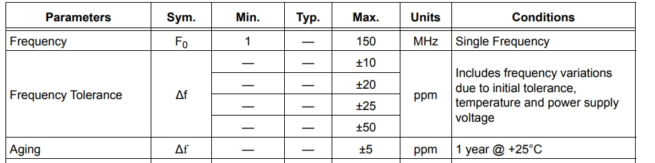

The offset each has in ppm?​
Why not use a common clock source?​

  1. Please see below screenshot from component datasheet.
  2. That's a good point. But, unfortunately I have a requirement that 2 chips need to be sourced with different source as one might fail.
