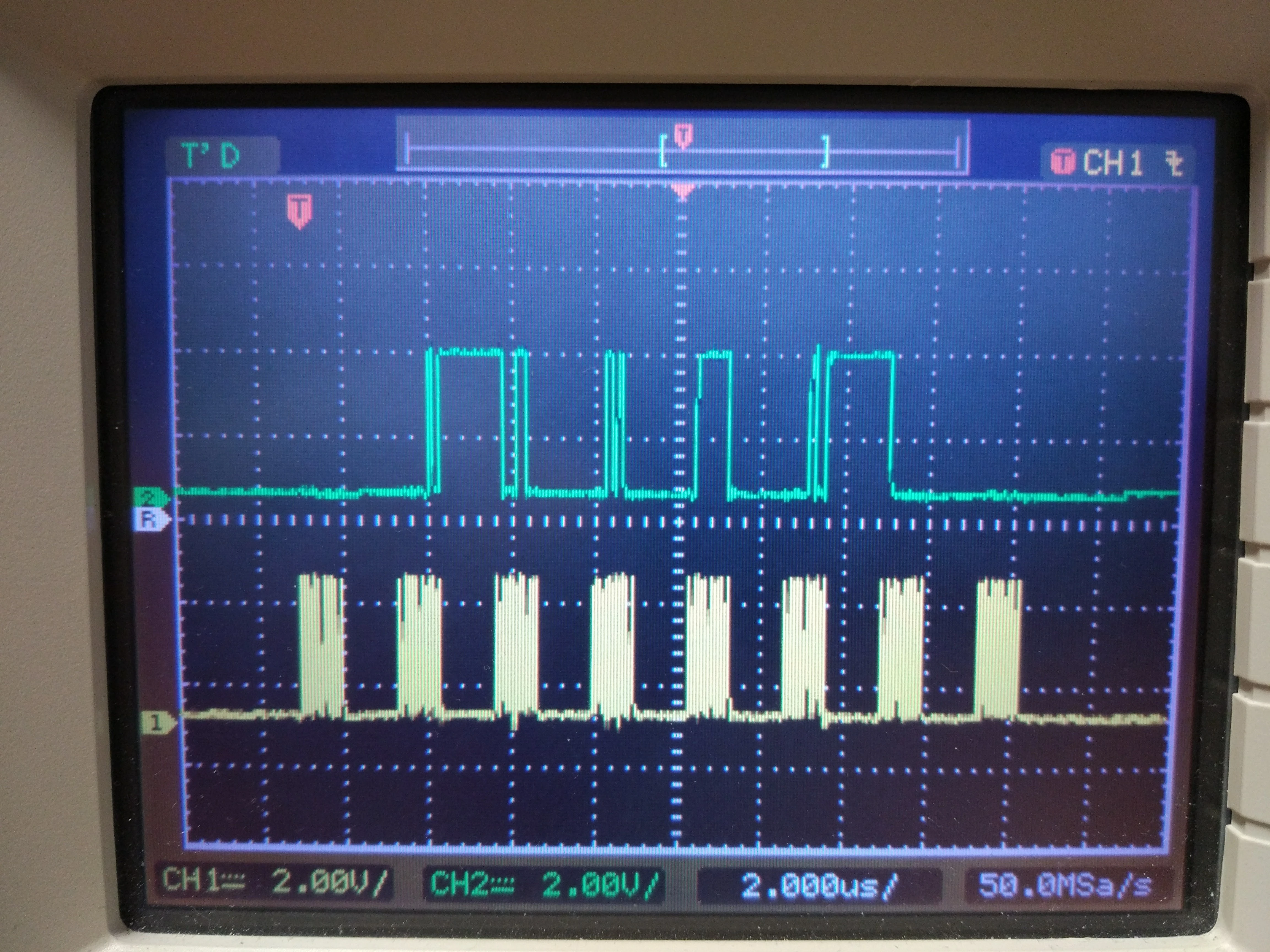

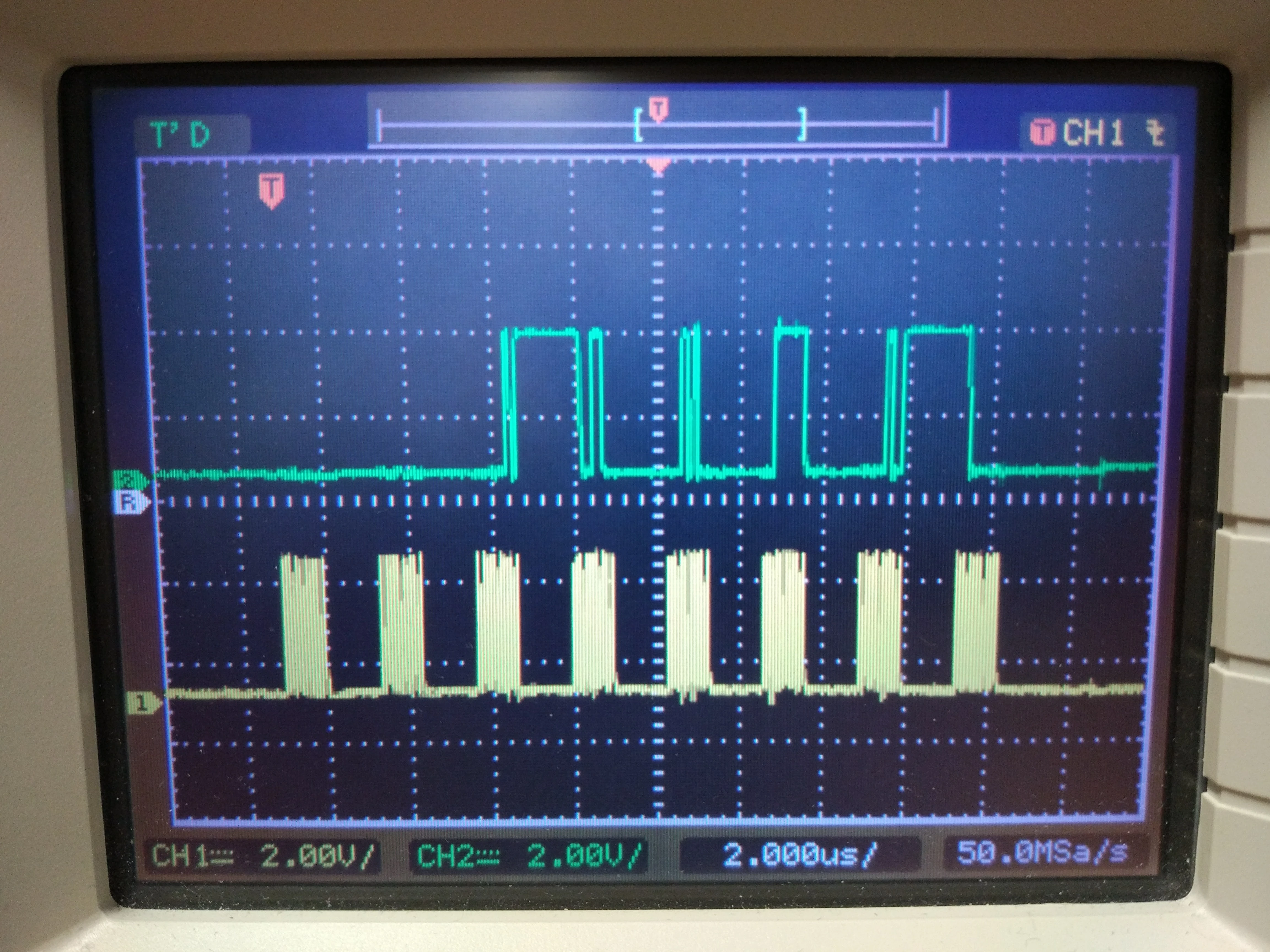

    de Haro Carbonell
    Aug 16, 2017 7:35 AM UTC
    Posted on August 16, 2017 at 09:35
    First of all, thanks for all replies and sorry for not answering earlier... i had a bank holiday and i couldn't continue with this...
    I add more information related to this issue i am still having...
    Here you can see the 8 bytes sent from slave to master (green), the clock signal (yellow) consist in 8 groups of 8 bits, this is what i m sending with :
    HAL_SPI_TransmitReceive_DMA(&hspi6, (uint8_t*)HMI_slave_TX_data, (uint8_t*)HMI_slave_RX_data, 8);
    uint8_t HMI_slave_TX_data[8];    this is buffer i use to send datas from slave to master.
    As you can see in the image, according to green signal, the first 8 bits and the last 8 bits, the HMI_slave_TX_data[0] and HMI_slave_TX_data[7]  values are 0x00.
    This correct comunication is working each 100ms. Master send to slave the chip select signal, the clock signal and the MOSI signal each 100ms, and the slave send this MISO signal properly.
    BUT after between 1min or 2 min randomly, the communication suddenly changed. The MISO signal is delayed as yo can see in the next capture:0690X000006041gQAA.jpg
    As you can see, the MISO signal should be exactly the same as prevous capture becasue HMI_slave_TX_data buffer is exactly the same all the time, but i dont understand why suddely the signal has being delayed to the next clock signal!! And as i mentioned, i checked the HMI_slave_TX_data buffer (using debug mode and also STM32 ST-LINK Utility in run mode) and the buffer was OK (only HMI_slave_TX_data[0] and HMI_slave_TX_data[7]  values are 0x00), so in both captures the buffer is the same (it contains the same 8 values), but in the second capture is delayed or moved to left one byte!!
    This wrong communication keeps all the time unless i reset the uC.

    waclawek.jan
    Aug 16, 2017 7:51 AM UTC
    Posted on August 16, 2017 at 09:51
    Apparently you don't have any explicit synchronisation mechanism between master and slave, relying on the fact that all 'packets' are 8 bytes long. But if the slave for some reasone misses a 'packet' it starts to transmit exactly like you've shown.
    Best thing is eliminating the root cause.
    Find out the reason why HAL_SPI_ErrorCallback() is called at all. I don't use Cube so I don't know what exactly this is, but if it's triggered by some of SPI states, read out the SPI status register at that moment. If you use a debugger, can do it by placing a breakpoint in that function and then observing the SPI registers (and, if needed, the DMA status registers too) in the debugger.
    You may also want to see what has happened on the scope - if your scope has an 'external trigger' input, connect it to PF1 and set it to trigger on the edge on this input.
