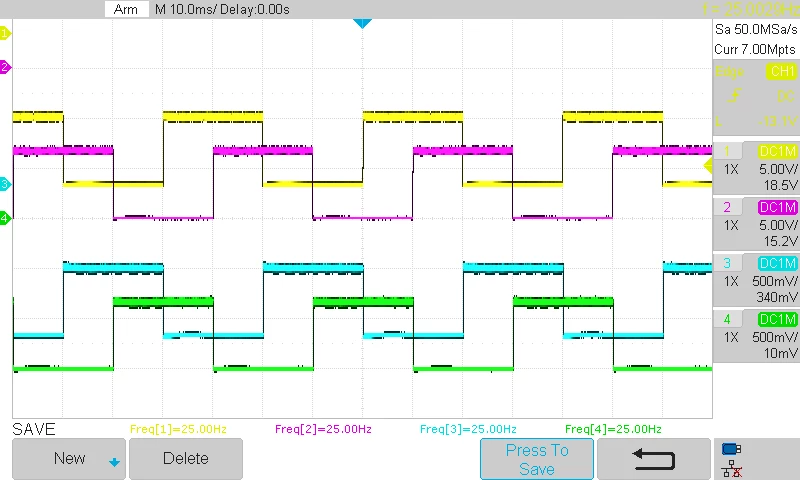

Hello, my problem is as follows:
I am working with an STM32G484QET6 uC. I have configured two timers with two output channels as Output Compare Toggle Mode. So that I get two independent quadrature signals.
I now want to synchronise these two quadrature signals. My idea of the procedure is like this:
1. stop both timer and signal generation
2. reset both timers
3. start both timer and signal generation
This is my code:
void syncTimers(void);
	HAL_TIM_Base_Stop(&htim1);
	HAL_TIM_Base_Stop(&htim8);
	HAL_TIM_OC_Stop(&htim1, TIM_CHANNEL_1);
	HAL_TIM_OC_Stop(&htim1, TIM_CHANNEL_2);
	HAL_TIM_OC_Stop(&htim8, TIM_CHANNEL_1);
	HAL_TIM_OC_Stop(&htim8, TIM_CHANNEL_2);
	TIM1->EGR |= TIM_EGR_UG;
	TIM8->EGR |= TIM_EGR_UG;
	HAL_TIM_Base_Start(&htim1);
	HAL_TIM_Base_Start(&htim8);
	HAL_TIM_OC_Start(&htim1, TIM_CHANNEL_1);
	HAL_TIM_OC_Start(&htim1, TIM_CHANNEL_2);
	HAL_TIM_OC_Start(&htim8, TIM_CHANNEL_1);
	HAL_TIM_OC_Start(&htim8, TIM_CHANNEL_2);

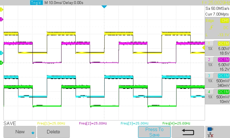

This works quite well so far, the Timers are then synchronised with each other. However, the problem is probably that, since I have configured OC mode Toggle, the start values of the quadrature signal are different and are therefore the signal is sometimes inverted.
Correct:
wrong:
My question now is this: How can I reset the pin value completely so that both timers start cleanly from 0? Or is there another way to achieve the wanted synchronisation?

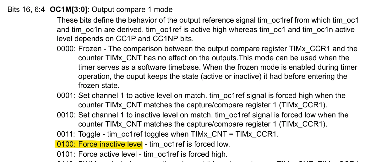

A few different ways to do this. Probably easiest is to force the value low by modifying OCxM temporarily before switching back to toggle mode.

Thank you very much, that worked, the leading signal is now always synchronised. However, it now sometimes happens that the phase shift signals are inverted in relation to each other.
I think this is due to the same problem as before. I also tried to reset them with the CCMR2 register, but that didn't work. Is there another possibility?
I thought I could solve the current problem by reading the status of the pins and correcting the phase shift manually. Can I do this with the HAL_GPIO_ReadPin() function, even though they are configured as timer output?
Aug 22, 2024 12:25 PM UTC
You're using channels 1 and 2 which are controlled with the OC1M and OC2M fields which are both in the CCMR1 register. That should work. CCMR2 controls channels 3 and 4.
Or use HAL_GPIO_ReadPin() but that seems more complicated.
