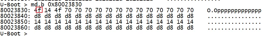

I try add eth support under uboot with my stm32f767igt board,my dts file as below:
ethernet_mii: mii@0 {
pins { pinmux = <STM32F746_PG13_FUNC_ETH_MII_TXD0_ETH_RMII_TXD0>, <STM32F746_PG14_FUNC_ETH_MII_TXD1_ETH_RMII_TXD1>, <STM32F746_PB11_FUNC_ETH_MII_TX_EN_ETH_RMII_TX_EN>, <STM32F746_PA2_FUNC_ETH_MDIO>, <STM32F746_PC1_FUNC_ETH_MDC>, <STM32F746_PA1_FUNC_ETH_MII_RX_CLK_ETH_RMII_REF_CLK>, <STM32F746_PA7_FUNC_ETH_MII_RX_DV_ETH_RMII_CRS_DV>, <STM32F746_PC4_FUNC_ETH_MII_RXD0_ETH_RMII_RXD0>, <STM32F746_PC5_FUNC_ETH_MII_RXD1_ETH_RMII_RXD1>; slew-rate = <2>; }; };&mac {
status = ''okay''; pinctrl-0 = <ðernet_mii>; phy-mode = ''rmii''; phy-handle = <&phy0>; snps,reset-gpio = <&gpiof 9 1>; /*PF9<-->ETH_RESET*/ snps,reset-active-low; snps,reset-delays-us = <1000 1000 1000>; mdio0 { #address-cells = <1>; #size-cells = <0>; compatible = ''snps,dwmac-mdio''; phy0: ethernet-phy@0 { reg = <0>; }; };};i conformed mdio relate pin PC1 and PA2 with AF11 function as below

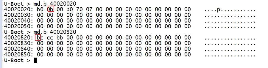

and GPIOC and GPIOA are enabled as

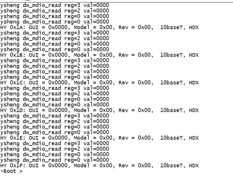

but whichever register of the phy chip i read i always get 0x0000,,,
i try use mii info command test again ,i get the same
