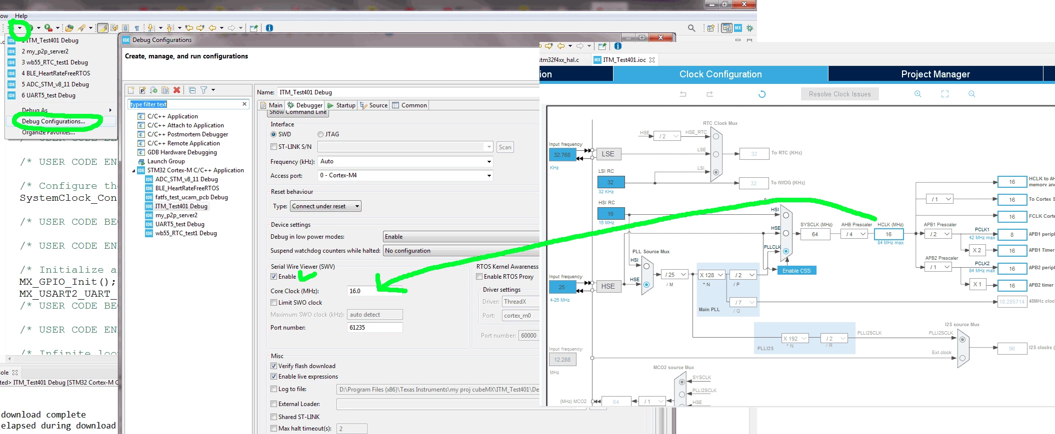

  •  Run -> Debug Configurations -> STM32 Corex-M C/C++ Application -> New launch configuration
  •  Debugger -> ST-LINK (ST-LINK GDB server)
  •  Serial Wire Viewer (SWV)
[x] Enable
 Core Clock 16MHz
 SWO Clock: 2000 kHz
 Port number: 61235
 [x] Wait for sync packet
  •  Apply -> Debug

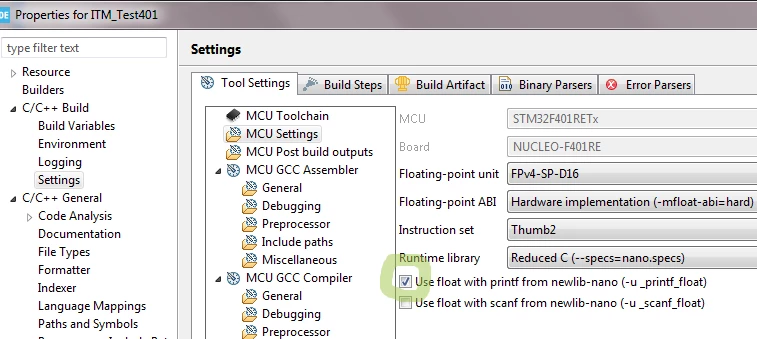

This is ITM example with printf float via ITM.
Also "Output gets flushed on reaching newline character or calling fflush(stdout) function. Additionally there is an option to disable buffering entirely by calling setbuf(stdout, NULL)."
