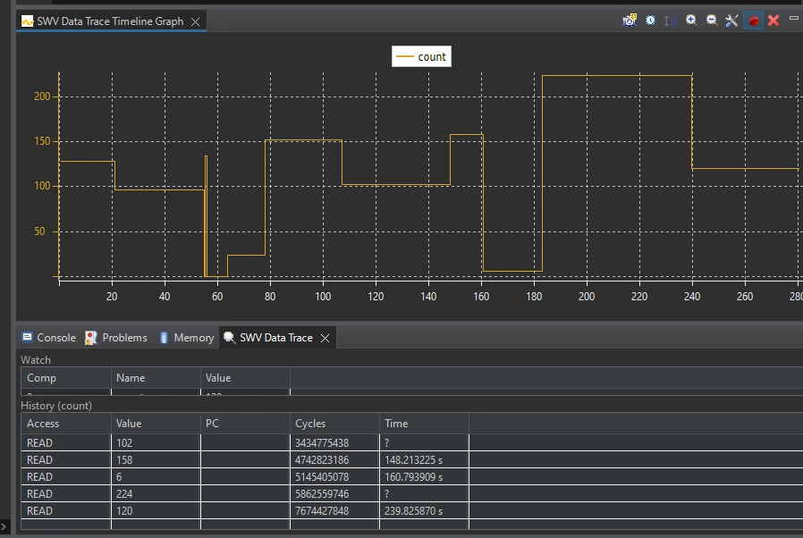

Hi!! To test how the SWV data trace timeline graph works, I have a simple application where I increment by 1 a variable called count. Very basic. In debug mode, I see count increasing correctly in the live expressions window.
while(1){
count++;
HAL_Delay(250);
This is not the case for the SWV window where the variable value are completely wrong.
0693W00000Y7pzUQAR.pngWhere can the problem be? Thank you!

    Solved: core clock was unintentionally set to a wrong frequency.
