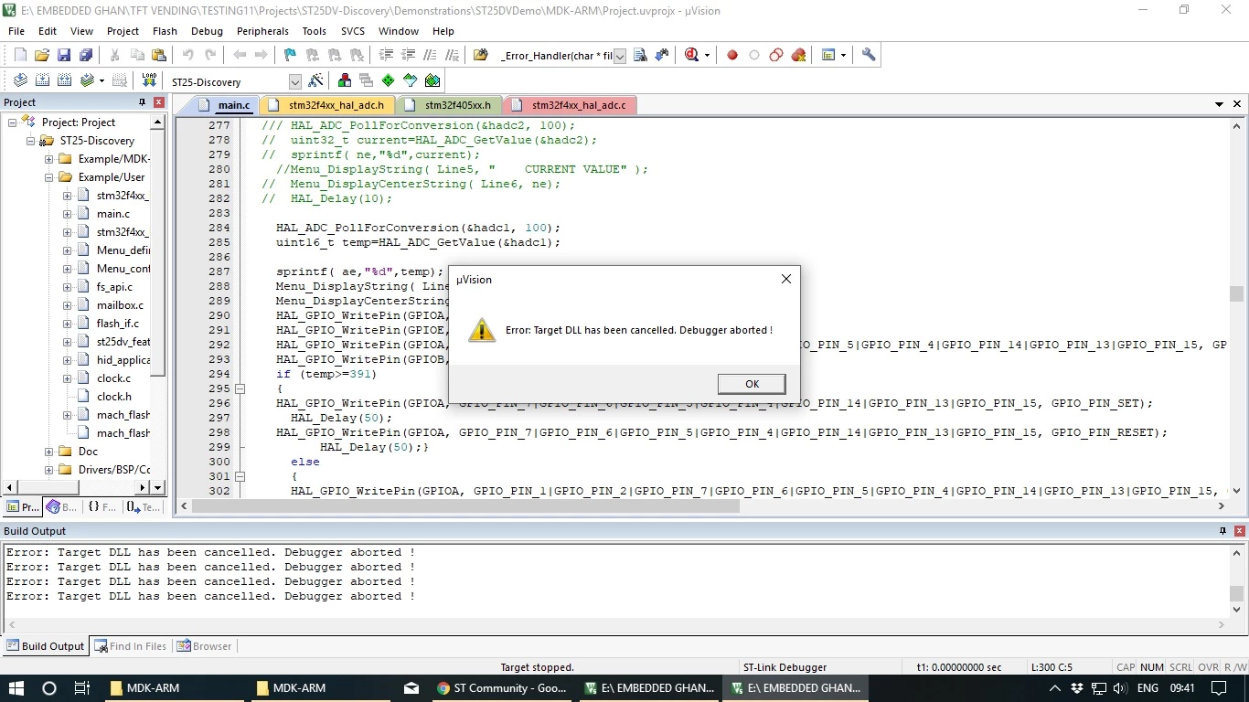

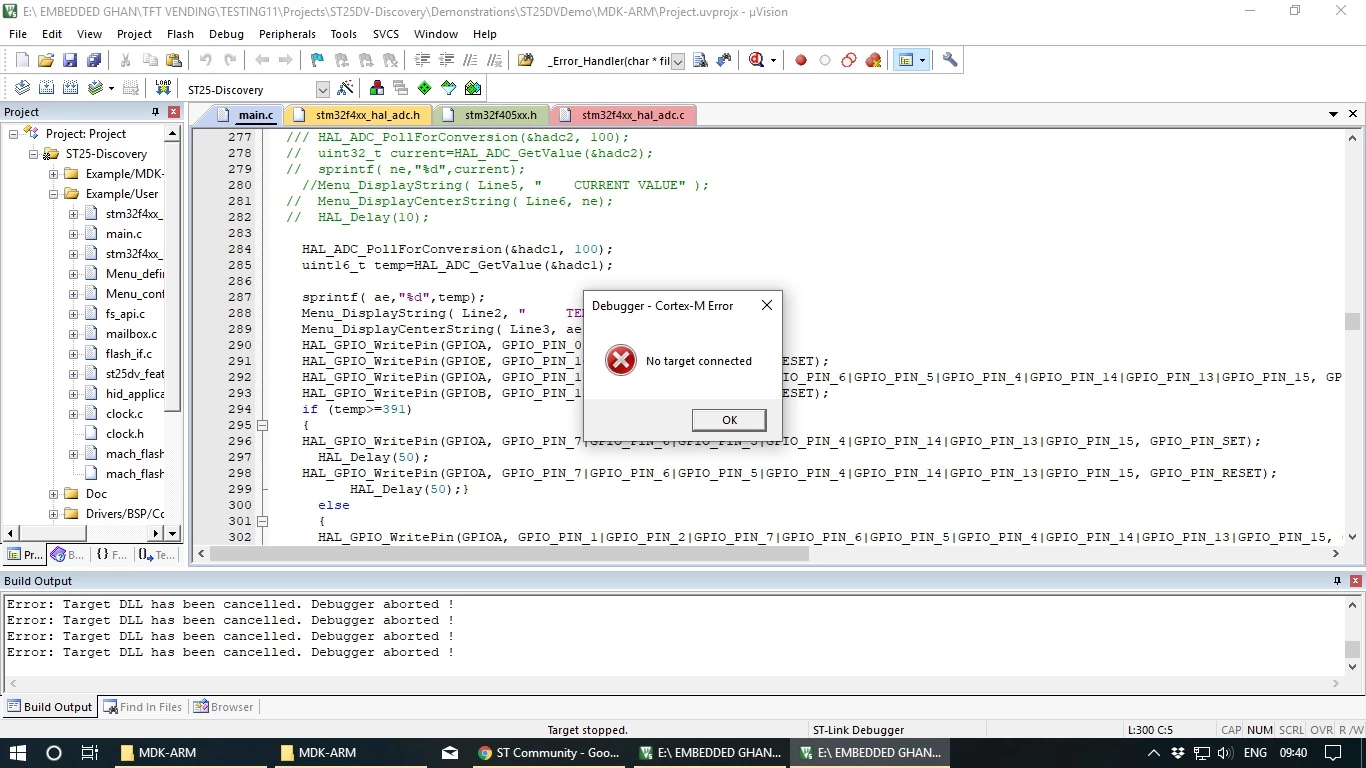

In my debugger settings I got there is some SWO frequency difference means before 2 or 3 days its frequency value is 10Mhz but now it is only 2Mhz and from last days I have getting some errors. So plz tell me that such errors are coming due to this change or not and how to re change SWO frequency ?

    PA13/PA14 are used by the debugger, if you use them in the application they will prevent or break connectivity.

    errors are

    Thank You Sir.
    Now my debugger is also enable after replace.
