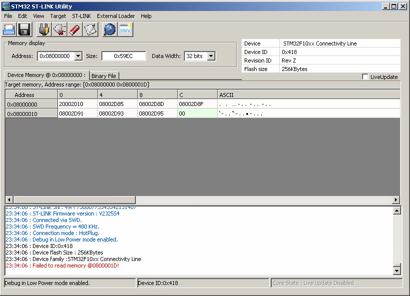

Hi!
I am having problems when using SWD cables to read/write on my STM32F105RC MCU. The MCU is on a custom board. I connect with ST Link Utility but get the error ''Failed to read memory'' 0x080000xx. At each connect it gives error on different memory places.
My cable-setup is:
Pin on MCU:46 SWDIO, 49 SWCLK, POWER, GND.
I know SWD cables is correct due to I have tested the two different F105RC MCU to rule out error on MCU. I have tested both MCU in a external EEprom burner (flash file to mcu also tested - ok).
Possible errors:
  • No resistor connected to SWDIO/SWCLK
  • PCB layout error?
  • BOOT0/1 is not connected from MCU
  • Connect reset (nReset?)
All help appreciated
Regards
Daniel
I also attach the picture from ST Link Utility if it is not shown in the post.

Do you have a circuit diagram? BOOTx pins just left floating? Any reset circuitry?
Does the behaviour change if you pull-up BOOT0?
Connecting NRST to the debug interface is always strongly recommended, it would permit ''Connect under Reset'' options to be workable.
Consider if the code already on the device puts it into a low power mode, or otherwise changes the GPIO pin configurations.

Thanks for your ideas to resolve the problem. I do not have a a circuit diagram for this custom board.
I have tried to pull-up BOOT0 and this made no difference.
I tried the Connect under reset with Nreset pin 7 from MCU to ST Link/V2 but no difference.
