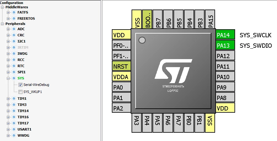

i made my stm32f030k6t6 board and i connect it to stlink
after that  i generate keil V5 project using stmcube .
i  enabled the SWD pins only , after that i compiled the program and download it ,i start the debugger ,but when the program execute the [HAL_RCC_OscConfig()] the debugger send message that it cant communicate with core and every thing stop working ??
#swd #stm32

With CubeMX generated code, pins are set to there default status if not configured with the tool.
To be able to debug the STM32F1 device in SWD mode, you have to select ''Serial-Wire'' in SYS configuration (Pinout wizard).
-Mayla-

@Mayla
i did what you mention  in stmcube
