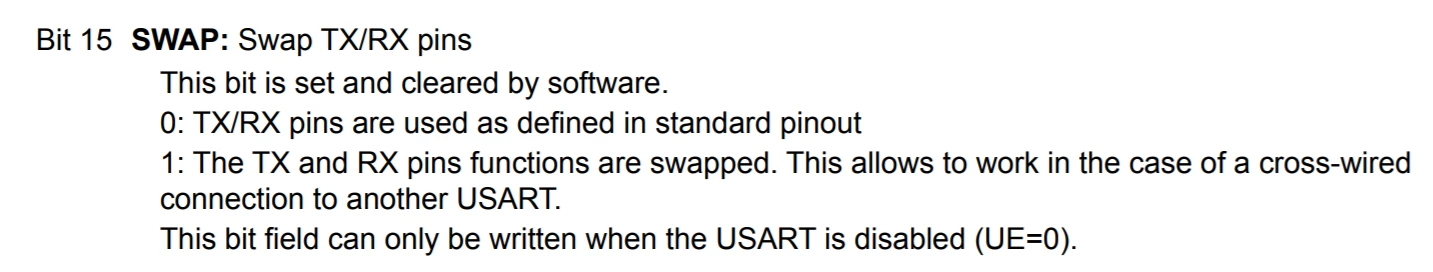

Swappable Tx/Rx pin configuration ?
The STM32F777 has a bullet under Section 2.25 [U(S)ART] :
Where can I find more detailed information on Swapping the Tx/Rx pin configuration for a UART ?
TDKBest answer
Jan 7, 2021 3:50 AM UTC
The reference manual is usually the best source of detailed information:
https://www.st.com/resource/en/reference_manual/dm00224583-stm32f76xxx-and-stm32f77xxx-advanced-arm-based-32-bit-mcus-stmicroelectronics.pdf
Take a look at the SWAP bit in the USARTx->CR2 register.
