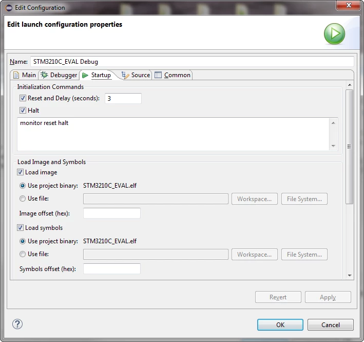

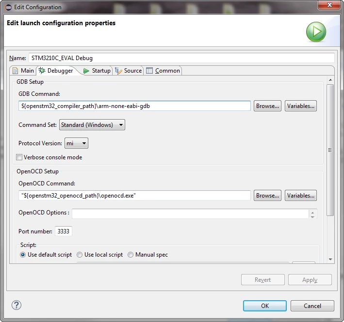

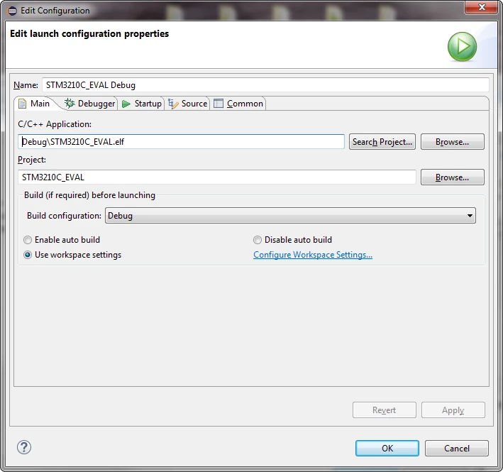

I am evaluating an STM32 chip with CAN with respect to the CAN enabled bootloader.
I have programmed for years on the TI CCS IDE on ARM4s.  SW4STM32 is a similar IDE.
I have SW4STM32 installed.  I have the STM3210C connected via USB.
I get the following when trying to debug:
Error in final launch sequence
Failed to execute MI command:
-target-select remote localhost:3333
Error message from debugger back end:
localhost:3333: The system tried to join a drive to a directory on a joined drive.
I am trying to get to the point where I can set a breakpoint on the first statement in main().
I have attached screen shots of my debug configuration settings, where I would guess my settings are not correct.
Might someone suggest what I have amiss?
Where may I find some SW4STM32 quickstart documentation?  Especially for the STM3210C-EVAL?

    Posted on March 23, 2017 at 13:36
    I apologize for not closing this thread earlier.  It turns out the sales rep did not give me the necessary emulator.  I assumed the emulator was embedded on the eval board.  It was not.  Once that significant issue was resolved, I was emulating in minutes.

    I think that this error is due to the pending debug session and may be you
     have many active gdb instances
    So,
    you need to close them from debug perspective (
    Window > Open Perspective > Other >Debug
    ), then from 'Debug view' you should terminate/remove all active sessions and be sure
    that all debug session are off.
    You would refer to the
    http://www.ac6-tools.com/content.php/content_SW4MCU//lang_en_GB.xphp
