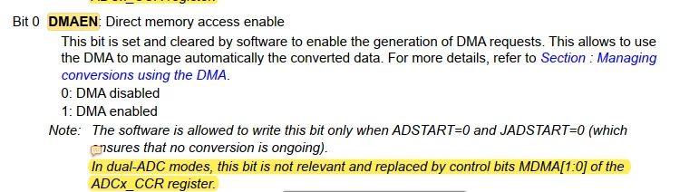

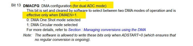

Suspecting document mistake in STM32L475
In dual ADC mode, the bit DMAEN is invalid as the doc said but in the below screenshot it is describing that the DMACFG bit in ADCx_CCR is effective only when DMAEN = 1.
Need help from you whether I am right or not? And I just want to know proper procedure to do.

Hello @Community member​ ,
This  is a typo: this should be MDMA instead of DMAEN
In the ADCx_CCR DMACFG, it should indicate “effective only when MDMA[1:0] != 0�?.
I have raised the error internally for fix .
Thanks for your contribution.
