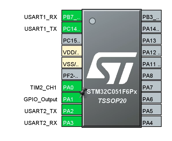

I think STM32C051F6 has the lowest price over this list: 0.425$ (10ku) fitting your requirements:  “32KB Flash and 12 KB RAM, 2 Uart, 1PWM, and 1 GPIO”:
Please confirm if this has answered your question.

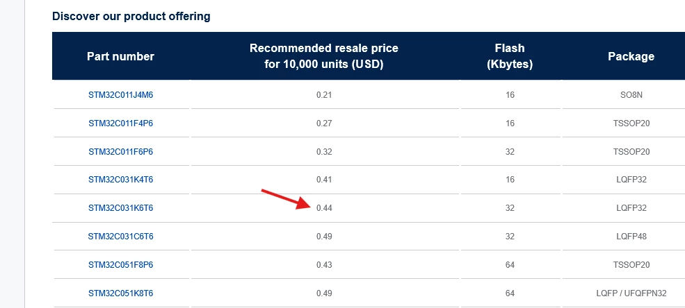

I tried it, but it doesn’t show prices column need to visit each stm32 separately, that can be humanly erroneous in search, and we need this for mass production, so cost matters lots, that’s why i asked for support here.

You could also search the product listings of distributors Farnell, RS, Digikey etc for the lowest price STM32 that fits your specification.
Then narrow it down to help search ST Site an MX as suggested.
You might find a distributor holding large stock of what you want at a good price.

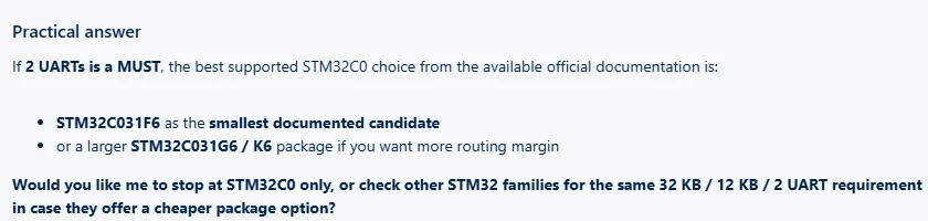

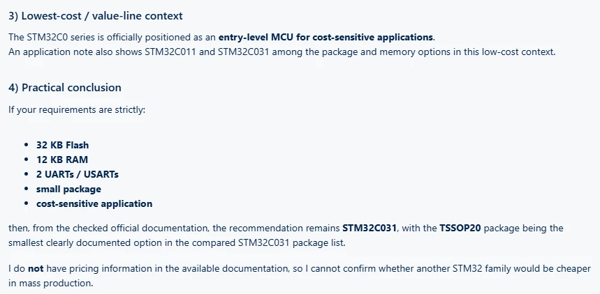

Dear ​@DBhut.1  ​@Ozone  ​@Chris21  ​@TDK  ​@rich.g.williams,
Thank you for the exchange and different options.   I wanted to invite you to explore “STM32 Sidekick” - Ask AI button ( right bottom) on the same question and try to engage a discussion to challenge the findings.
I tried today and here is the answer :
Your feedback is welcome.  Price list is not yet supported but is on the roadmap
Cheers,
STOne-32.
