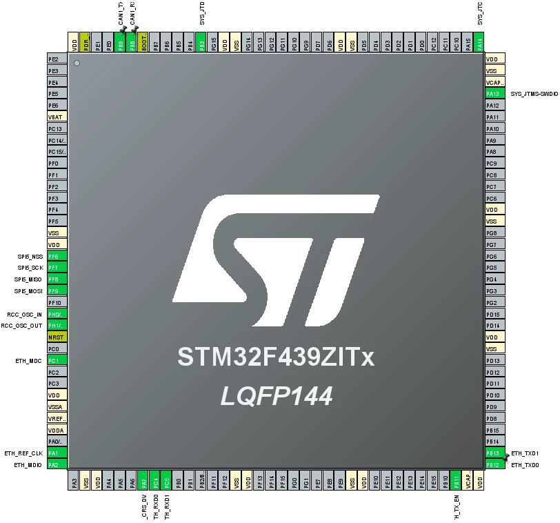

Currently, NUCLEO-F439ZI Demo Board is used, but only few pins/functions of the STM32F439ZI chip are necessary for me, the used pins shown as below (20 out of 114 pins are utilized):

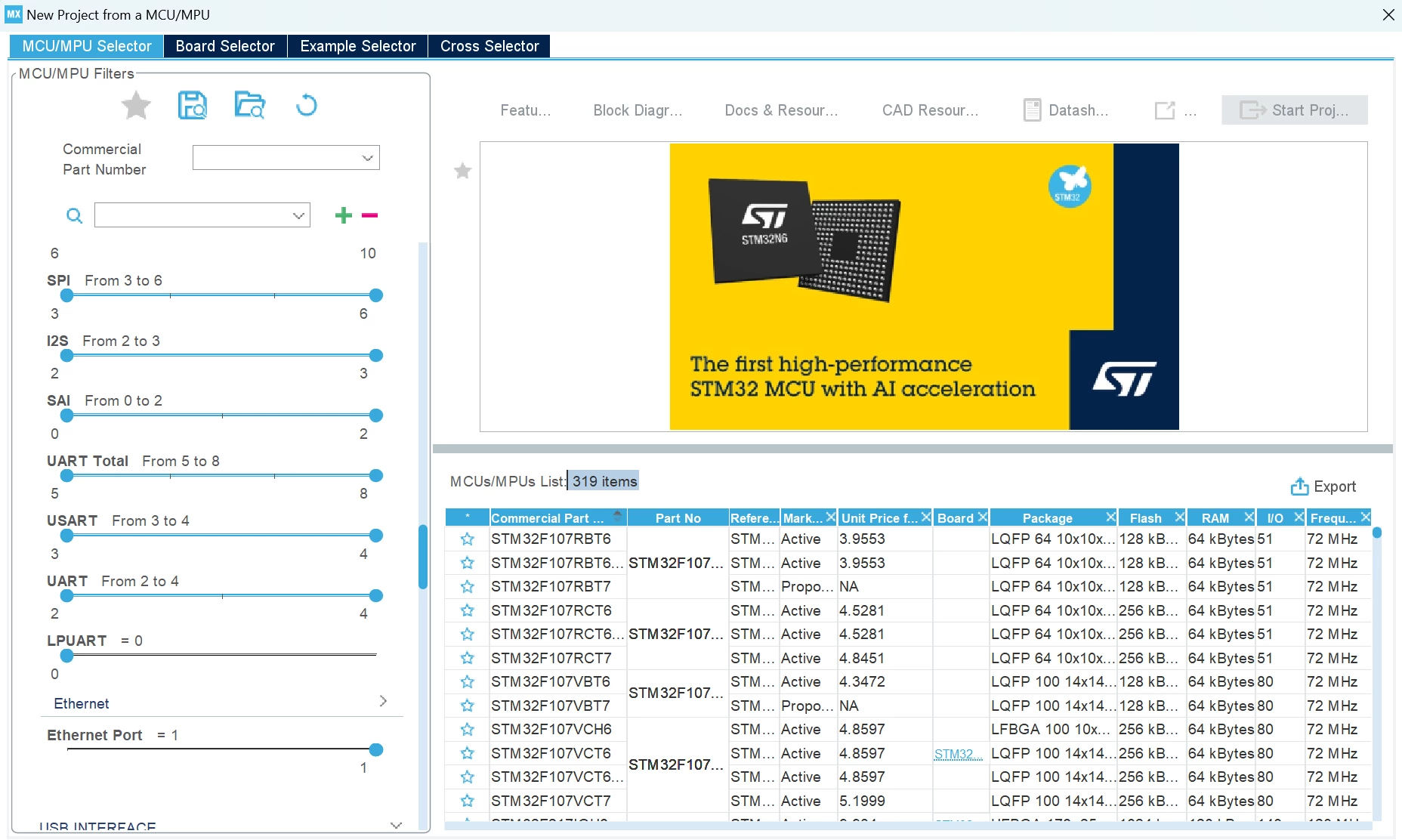

Then, I started to search appropriate chip by STM32 CubeMX, but the search list included more than 300 parts.
Therefore, is it possible for you to provide suggestions for an alternative STM32 MCU that has the following features:

You have actually already taken the right path to selecting the right MCU. However, if you set the filters according to your requirements, you will not find a package smaller than 64pins, as an Ethernet MAC, a CAN MAC and the necessary flash require quite a lot of chip area, which is why a smaller package is not sensible. If the 64pin or 68pin packages come into question, you could take a look:
  • STM32F107RBT6 (LQFP64)
  • STM32F107RCT6 (LQFP64)
  • STM32H563RGT6 (LQFP64), STM32H563RGV6 (VFQFPN68)
  • STM32H563RIT6 (LQFP64), STM32H563RIV6 (VFQFPN68)
  • STM32H7R3R8V6 (VFQFPN68)
Hope that helps?
