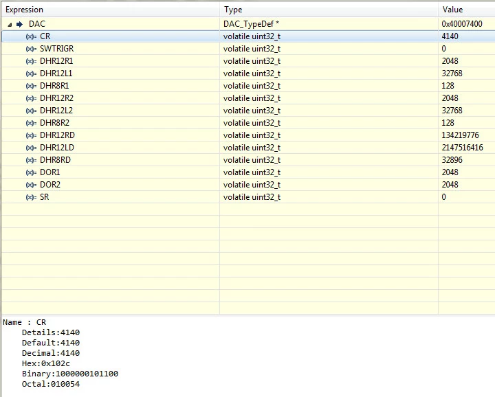

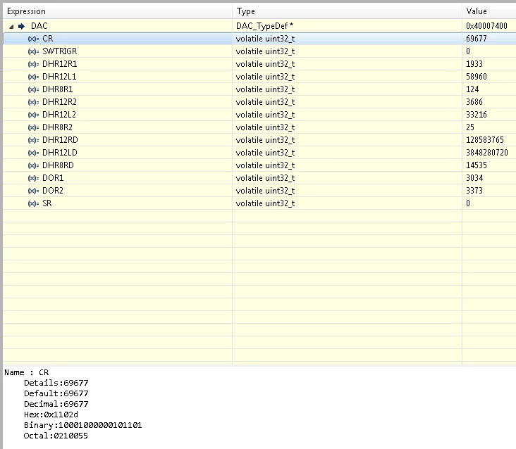

PHolt.1
PHolt.1Author
Senior
November 26, 2021
My Q (Q=question, indeed) centres on whether DAC2 needs to be in any special mode, in order to receive the top half of the 32 bit value.
The way the 32 bit mode works (I have spent hours googling of course, but most example online are useless) is that only one of the two DACs need to trigger the loading process. The other DAC seems to "just work" when the 32 bit value is loaded into DHR12RD.
In this case (a waveform generator) TIM4 triggers DAC1, and DAC1 triggers DMA1 to load the 32 bit value, which incidentally is also loaded into DAC2.
As I said, I have a working system but don't want to do something which could break.
After the above init, this is in there
https://peter-ftp.co.uk/screenshots/202111264713675013.jpg
and after
DAC->CR = (1u << 12) // DMAEN1=1 - DAC1 DMA1 enabled
|(5u << 3) // TSEL1=5 - DAC1 trigger source Timer 4 (Timer 4 TRGO event)
|(1u << 2); // TEN1=1 - DAC1 trigger enabled
this is what is in there
https://peter-ftp.co.uk/screenshots/202111262013685213.jpg
Thank you for looking at it.
To me it makes sense that DAC2 config is irrelevant so long as it is enabled.
waclawek.jan
November 26, 2021
You can copy/paste pictures here.
OK so the latter one:0693W00000GZ4c8QAD.png
is taken from the state when DMA works and generates varying output on both DAC1 and DAC2?
That's strange as DAC_CR=0x102c thus both DACs are disabled ...

waclawek.jan
November 26, 2021
> But why:
> sConfig.DAC_Trigger = DAC_TRIGGER_T5_TRGO;
> Looks like you choose timer 5 as trigger, but you set up timer 4?
That's obviously evolutionary code, overriden later by direct write to DAC_CR.
DAC has only one relevant register (DAC_CR) to be configured in the vast majority of cases.
waclawek.jan
November 26, 2021
> I may not have made my Q clear. It concerns whether DAC2 needs any special config (trigger from a timer, or request a DMA) when the 32 bit mode is being used.
The Q is absolutely clear, the answer is, as so often, in careful reading of RM.
I've hinted previously:
>> What's content of DAC_CR.TEN2? (read: read its description in RM).
If DAC_CR=0x1102D, DAC_CR.TEN2 is zero, then according to its description:
0: DAC channel2 trigger disabled and data written into the DAC_DHRx register are
transferred one APB1 clock cycle later to the DAC_DOR2 register
In other words, whatever is the way how a value is written to the upper half of dual-data-holding-register (i.e. including DMA), it will eventually end up in the output-register.
The difference (maybe drawback) compared to setting where DAC2 would be triggered by the same trigger as DAC1 (i.e. if TEN2=1 and TSEL2 = TSEL1) is, that values to DAC2 are output almost immediately after DAC writes to the holding register, whereas to DAC1 are output when the trigger arrives. In short, DAC2 and DAC1 are outputs would be phase-shifted by roughly the trigger (TIM4 update) period.
