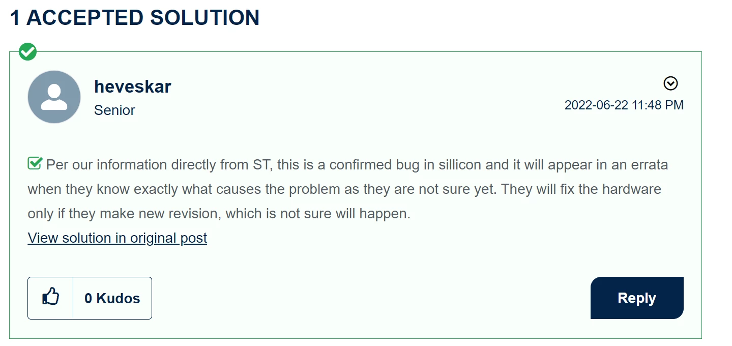

During our development process, we encountered an issue with using PC2_C to control SPI2 (SPI2_MISO), where it consistently pulls low. Despite extensive debugging efforts, including configuring the pin as GPIO and measuring with a logic analyzer, the issue persisted. Upon researching similar cases on the ST Community forum STM32H735V (LQFP100) PC2_C and PC3_C speed and FAQ: Default State of STM32H7 switches connecting Pxy_C and Pxy pads, we realized it might be related to a known issue in the STM32H7 family, specifically a bug in the silicon regarding the PC02 pin.

and the issue is the same as what was discussed in the ST Community forum "Regarding STM32H735V (LQFP100) PC2_C and PC3_C speed, as well as the FAQ regarding the default state of STM32H7 switches connecting Pxy_C and Pxy pads". Could you help me confirm whether the issue lies with a bug in the silicon regarding the PC2_C pin, or if it's something else?
I don't think it's the same issue.
Your are not arriving to toggle the IO while for the other threads the subject is related to timing issue. Which is already known.

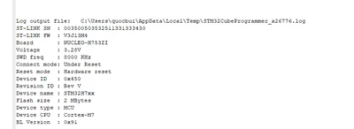

April 3, 2024
Hi @Andreas Bolsch, FYI, here is the chip information on NUCLEO-H753ZI Dev-Kit:
