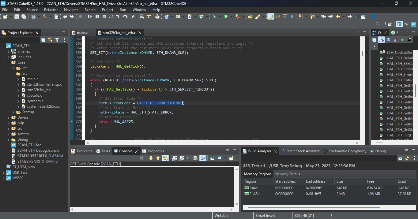

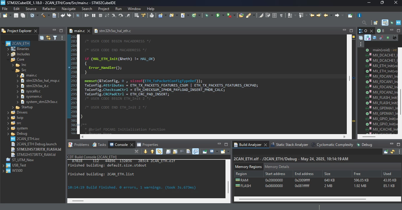

Now I’m trying to bring up Ethernet using the LAN8742 PHY, which is connected via RMII. However, I’m encountering an issue during initialization — specifically, HAL_ETH_Init() fails and returns the error:
HAL_ETH_ERROR_TIMEOUT.

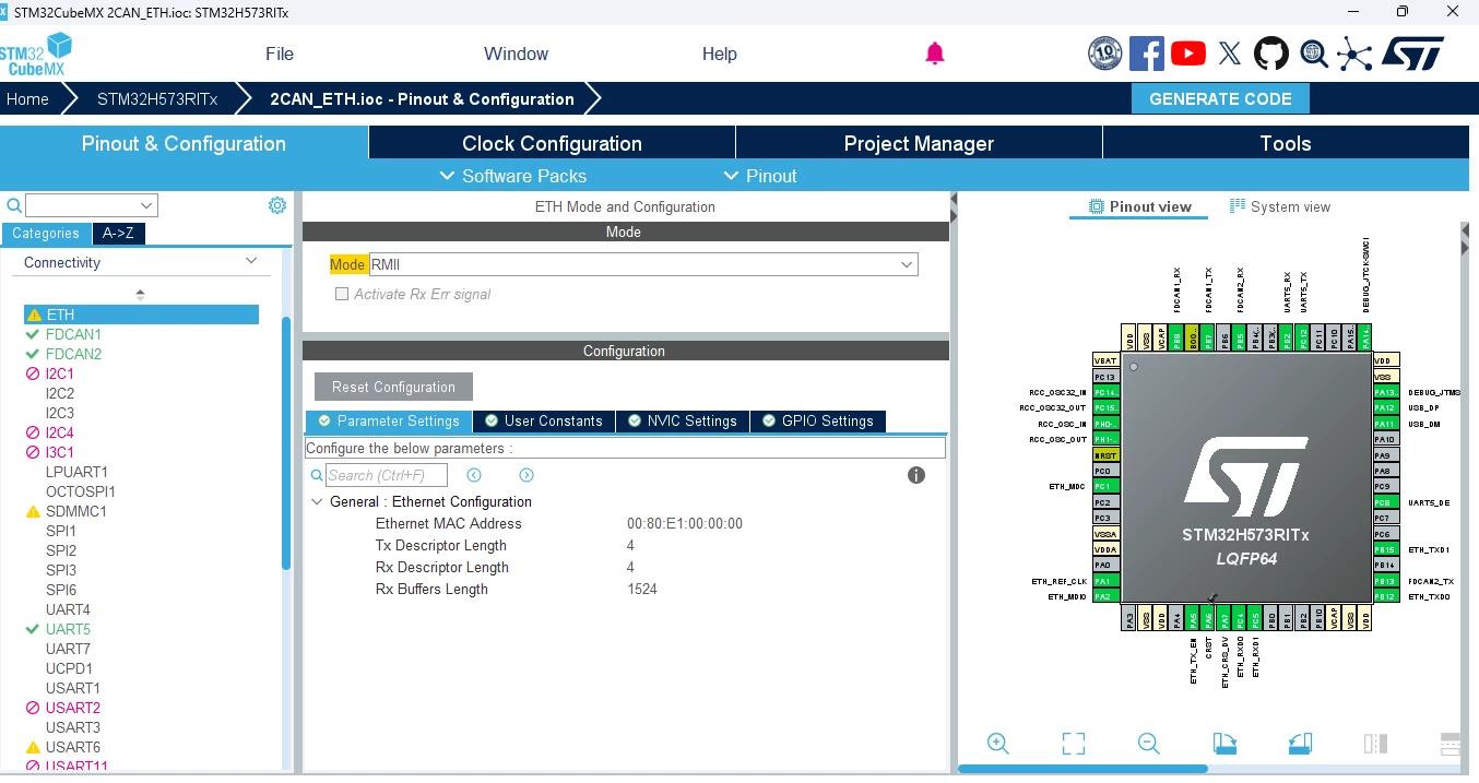

  • Configured using STM32CubeMX (default settings mostly)
  • No RTOS — standalone implementation
  • Using STM32Cube HAL drivers
I’ve double-checked the hardware connections — 50 MHz clock is present, reset pin is pulled correctly, and MDIO/MDC lines are connected properly. The PHY address is set to 0 (default), and matches the CubeMX configuration.

> What usually causes HAL_ETH_ERROR_TIMEOUT during HAL_ETH_Init()?
IIRC reset of the ETH device waits for some handshake with the PHY so it can timeout because of PHY problem.
While waiting for more useful replies, re-check the PHY.

1) Use the debugger to find out where exactly init fails.
Most of the time ETH init seems to fail because of missing interface clocks when the SWR bit is not reset by HW.
So, check your clocks and IOS once more, also the GPIO settings of the MDIO interface.
2) The LAN8742 is pretty easy to handle, I think. Maybe check again schematics, and how HAL sets it up.
