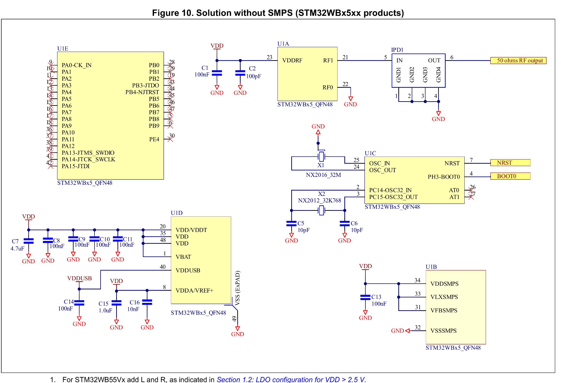

I created a new project with STM32Cube Version: 1.13.2 on Linux, selected my microcontroller (STM32WB35CCU6A), enabled all peripherals necessary (including USB and SWD, haven’t enabled anything RF related (yet)), and tried to upload my code on a brand new IC on a custom PCB. For the PCB, I followed the schematic without SMPS in AN5290 as shown on this screenshot.
I should also mention that I added a 100nF capacitor on nRST, as well as a pulldown on BOOT0 and two push buttons to pull nRST low or to pull BOOT0 high, and I didn’t try to use these pins for my application. Didn’t forget to supply Vbat. For the crystals I made sure to use compatible ones and used appropriate values for the capacitors that go with them. When entering application mode, the board (which contains other devices) draws ~20mA and ~30-40mA when I enter the bootloader with BOOT0. I use a cheap unofficial st-link v2, after connecting to the pc STM32Cube proposed to update the firmware on the st-link, It worked and after this I’m still able to program blue pill board with it (via SWD).

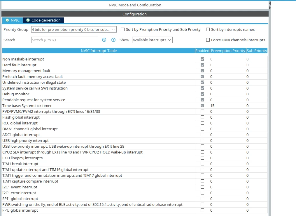

- However, it seems that there is a problem entering the while(1) of the main generated by STM32Cube. The only code I added is one to blink an output which is tied to an external 100k pull-down and the enable input of some IC, that’s in the while(1), and I also added a write 1 (with HAL_GPIO_WritePin (thing_GPIO_Port, thing_Pin, 1);) in the Error_Handler() to try and see if something was going wrong. However, I never saw this ouput GPIO going to Vddd.

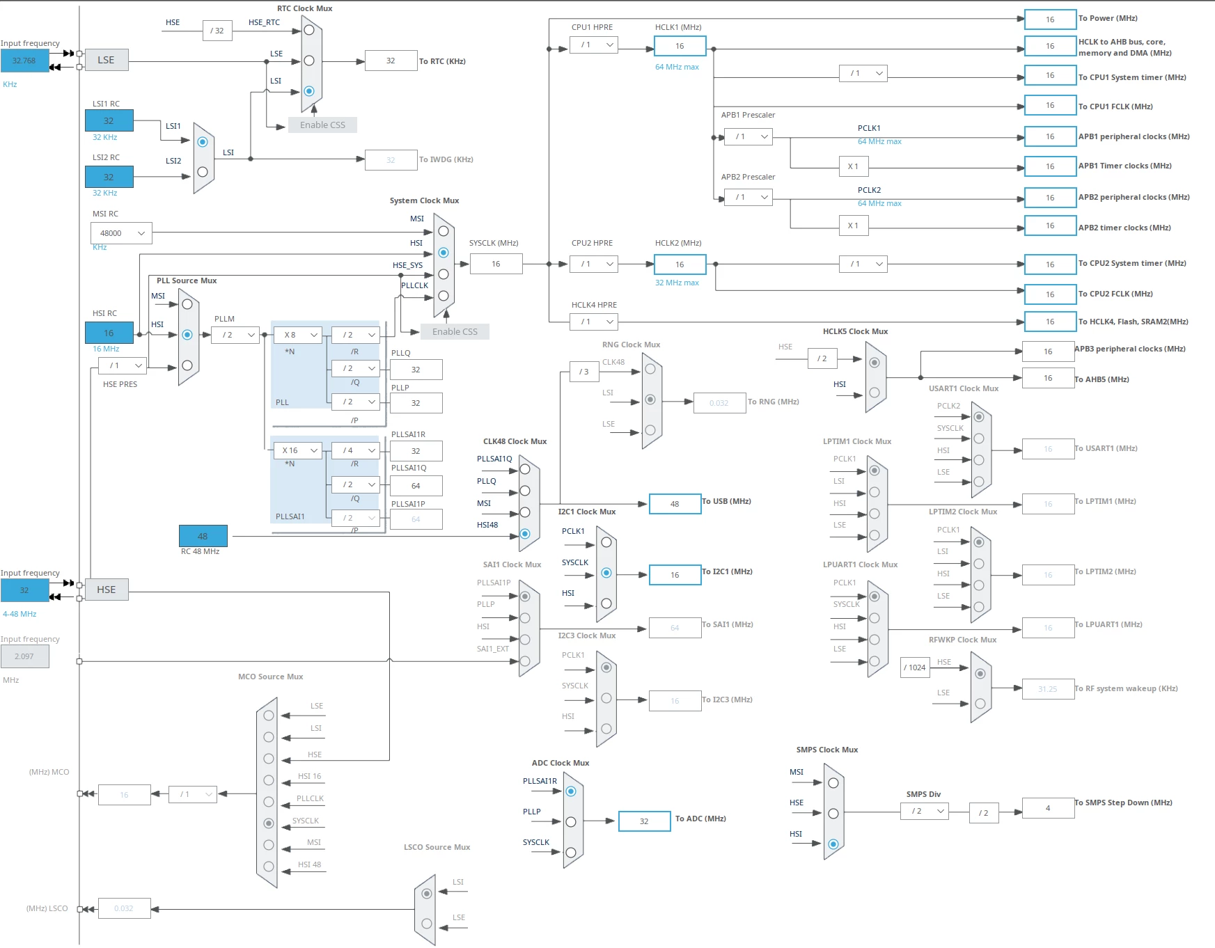

I looked at SWDIO and SWCLK, I see a lot of toggling when I try to upload/debug with SWD. I checked every voltage of the decoupling capacitors, I can see a solid 3.3V and I never saw it dropping by even a mV when I reset the chip to re-enter application mode. nRST stays at 3.3V and BOOT0 stays at 0V when I try to enter application mode. I resoldered the chip 3 times, it looks good, and I tried to replace the chip by another one one time, but to no avail. I tried to check for shorts, disabled the use of LSE and HSE to replace it with LSI and HSI, replaced all input interrupt pins with inputs, re-uploaded dozens of time with DFU using STM32CubeProgrammer and checked what had been wri, still can’t see this pin going toggling or going high. I also tried to use another pin which is also connected to a 100k pull-down and some chip enable input. At this point I have no idea what to try, and would greatly appreciate any advice.
