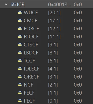

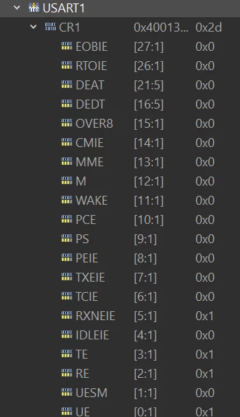

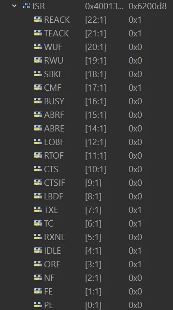

When I run this code with the debugger, the first interrupt goes into the RXNE case, then immediately enters the ISR again and none of the status checks return true, so the code just keeps entering the ISR repeatedly and none of my RTOS tasks run.  The state of the USART1 ISR, ICR, and CR1 registers while "stuck" in the ISR follow:
I see the Overrun bit set in the ISR register, which makes me think the USART1 is interrupting due to and RX overrun, but why isn't it getting cleared in the interrupt service routine (ORE case)?

Best answer by Dazai
I think my issue was due to enabling the transmit DMA during USART setup.  I don't want to enable it until a LIN message needs to be sent.  Commenting out that line seems to have resolved the problem.
