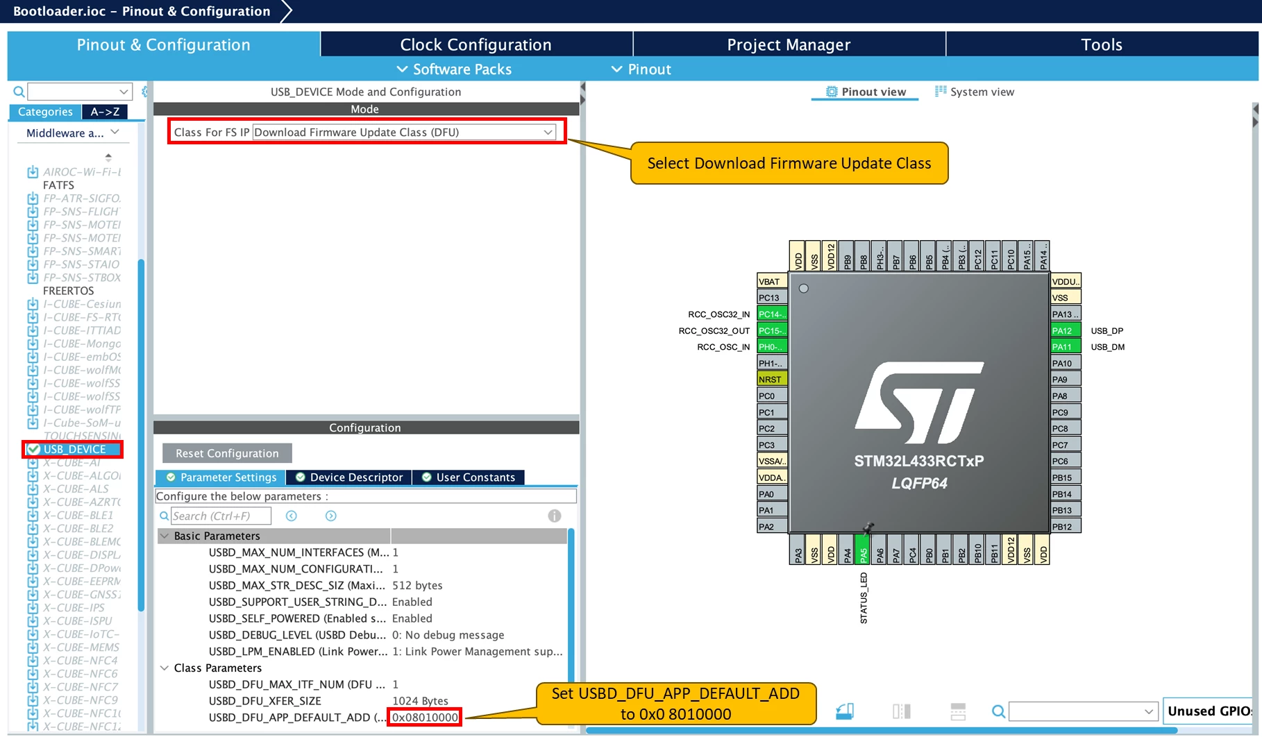

I have written a custom bootloader that is running on a Nucleo-L433RC-P board.
The application uses USB CDC to call the bootloader and the bootloader uses USB DFU to download the application.
I wanted to use USB to call the custom bootloader, rather than having to use a physical switch on the BOOT0 pin to call the internal bootloader

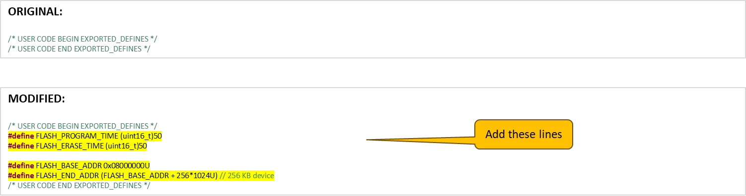

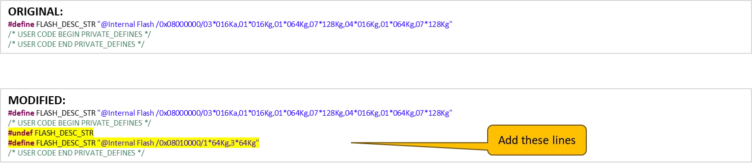

The implementation is shown below.

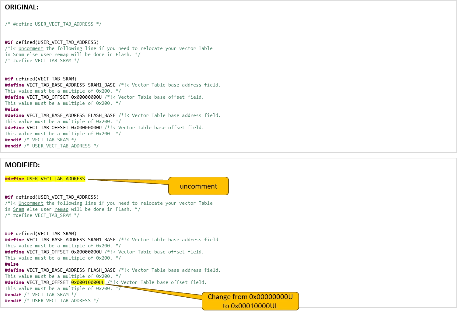

Bootloader USB configuration...

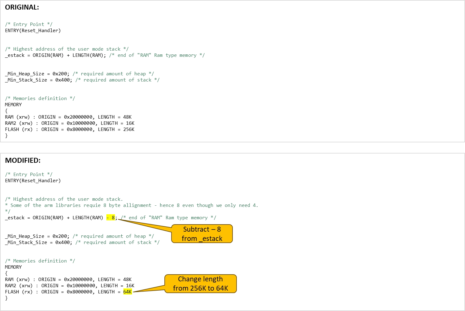

Changes to bootloader linker script...
Bootloader main.c...

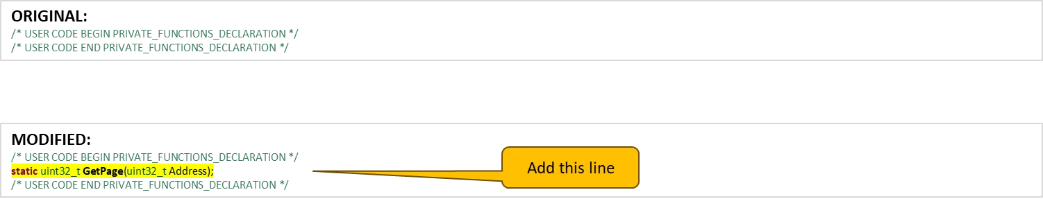

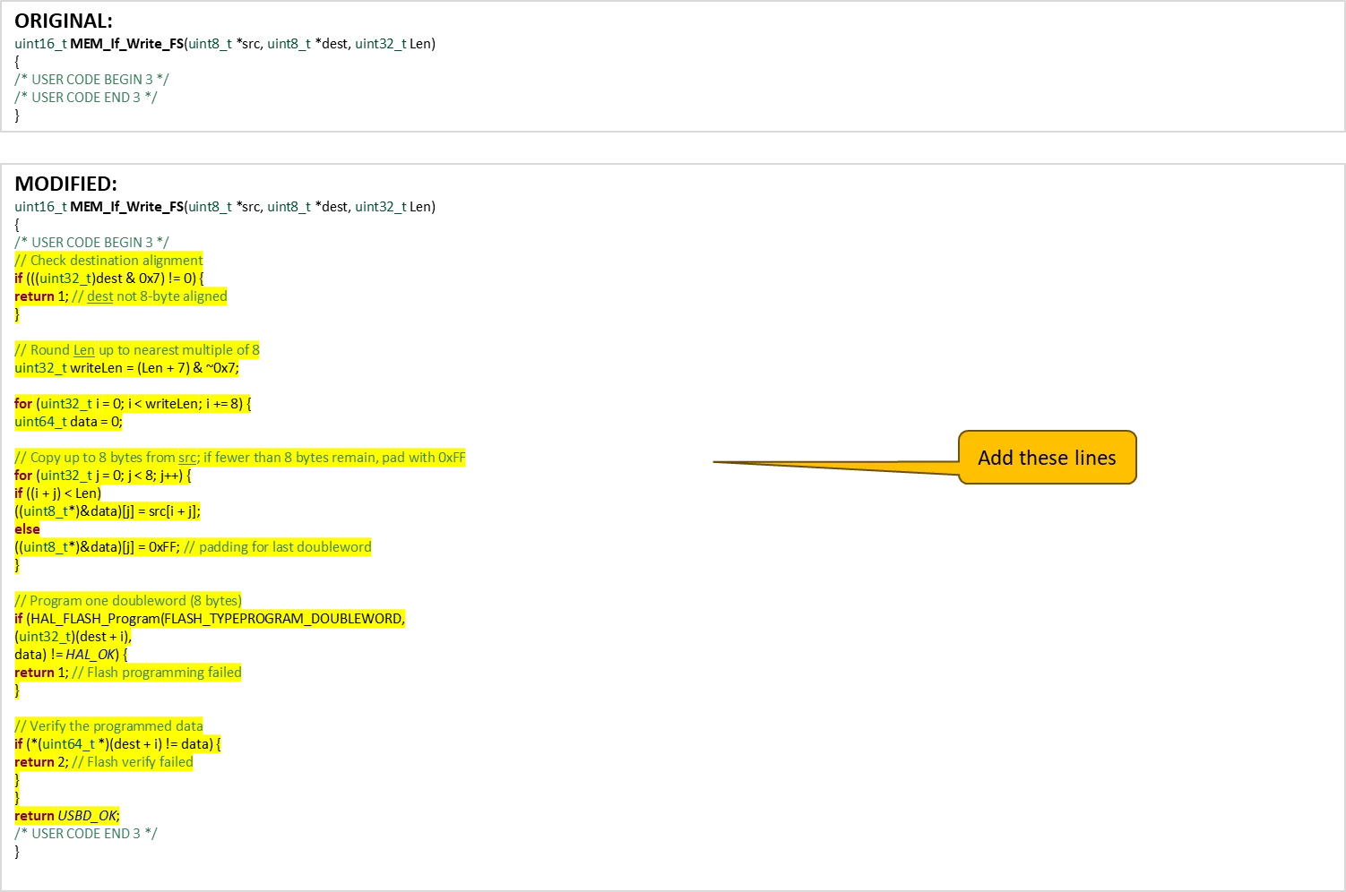

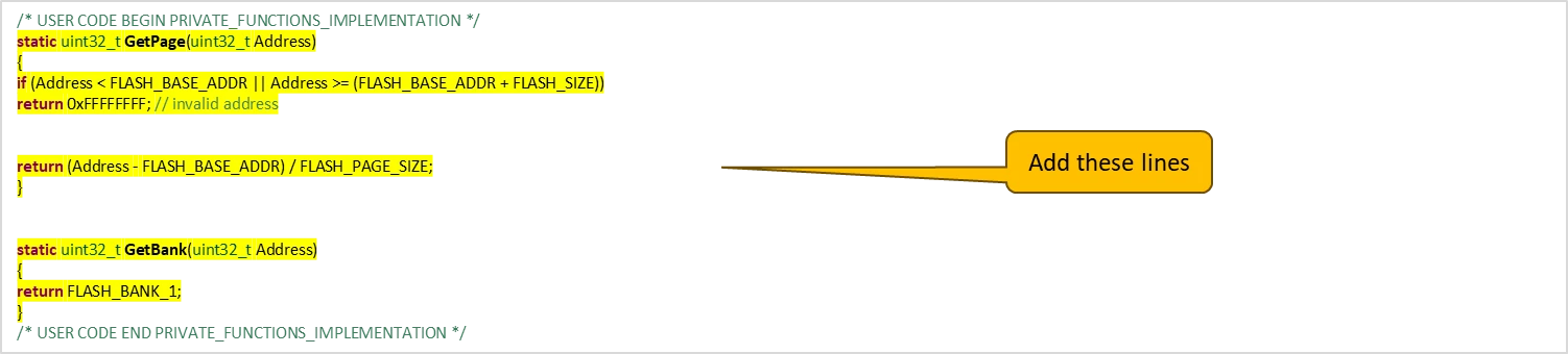

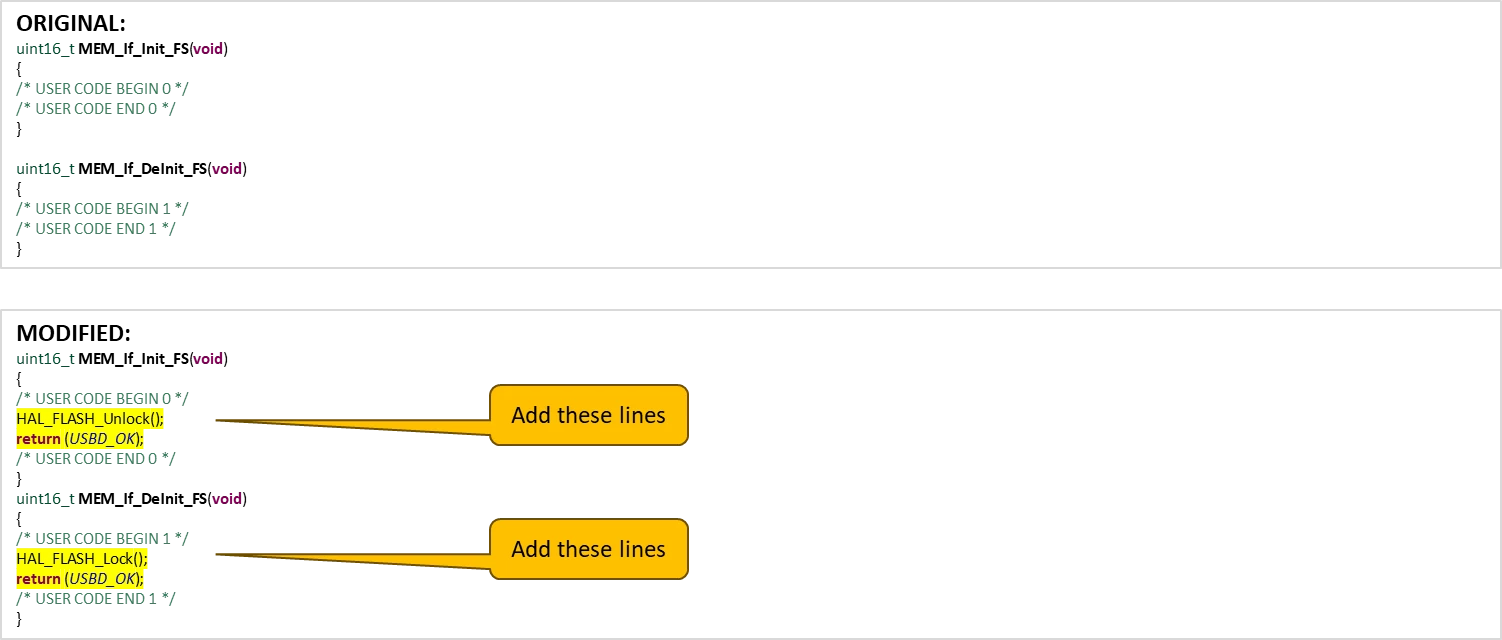

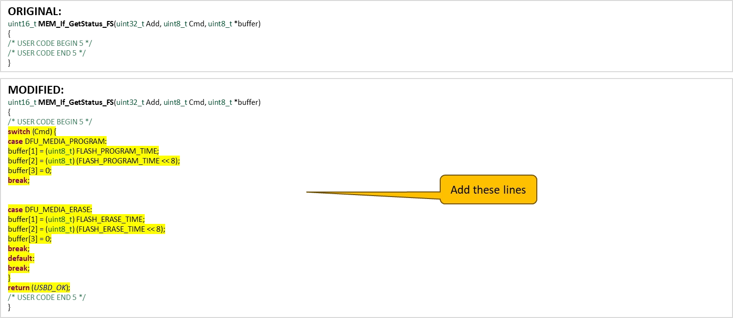

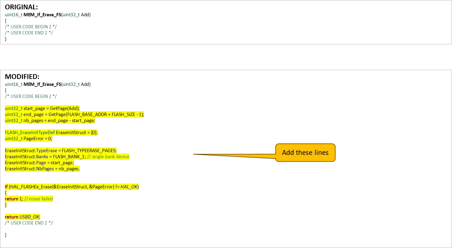

Changes to bootloader usbd_dfu_if.c....
Changes to bootloader usbd_dfu_if.h....

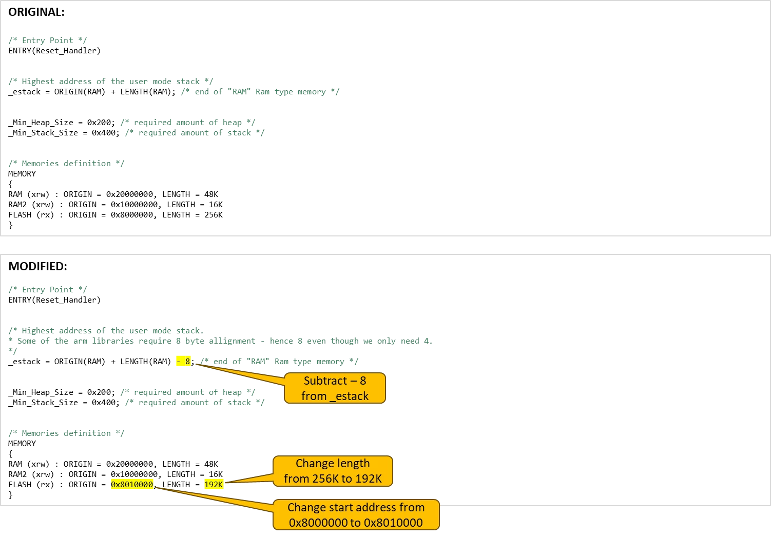

Changes to application linker script...

Changes to application system_stm32l4xx.c...

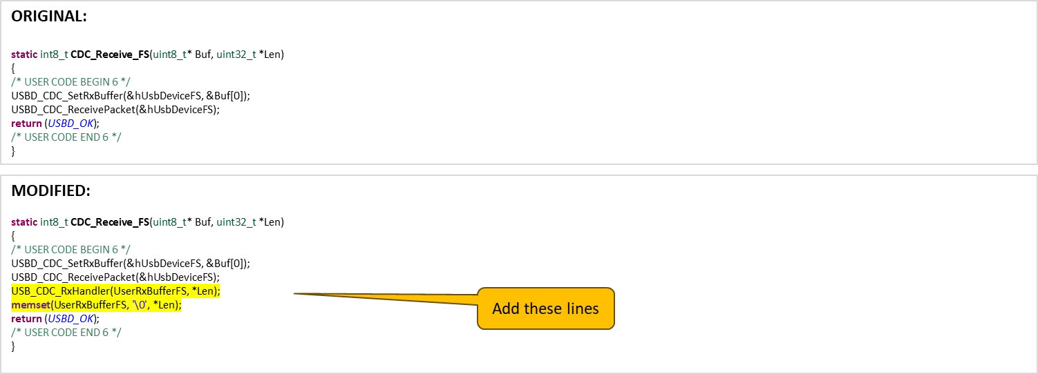

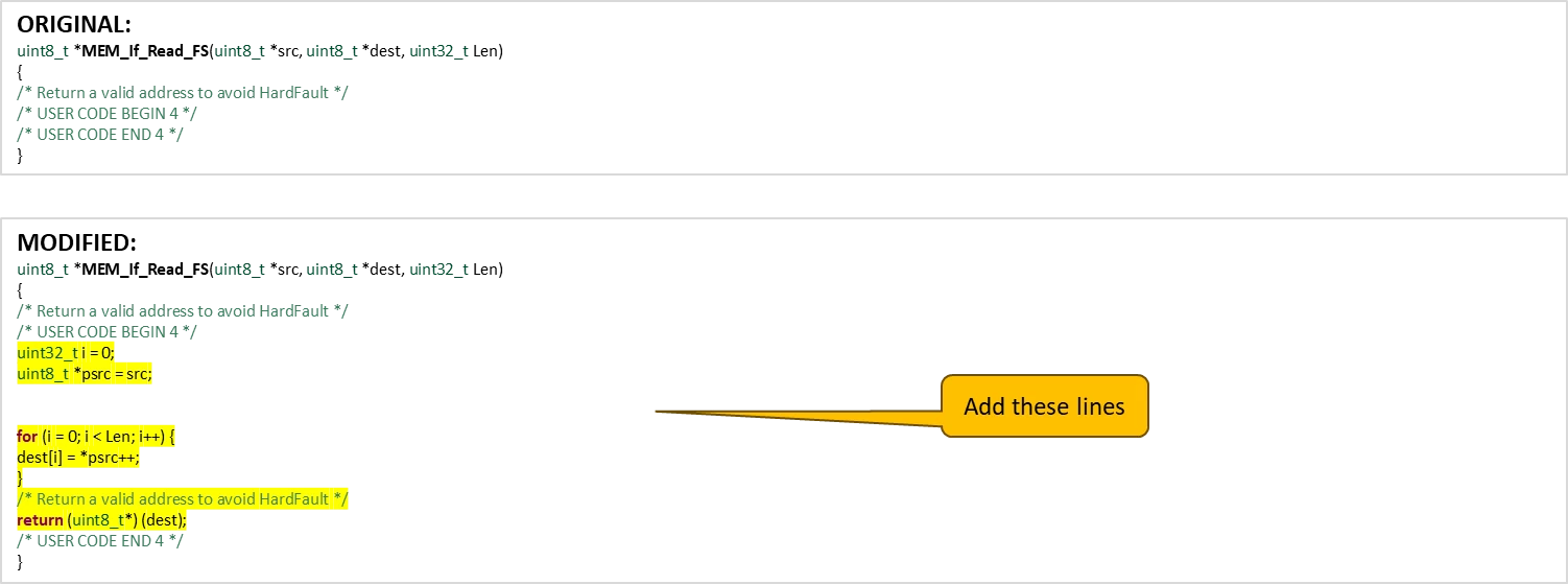

Changes to application usbd_cdc_if.c...

Does your bootloader relocate the VTOR after the jump?
If you do not modify the startup_stm32xxxx_init.c file or, as I always do, place SCB->VTOR = to the address of the app in memory, any try of using interrupts would fail!
I see you indeed modify the startup file but for sake I would also add the  SCB->VTOR = xxx before the call to HAL_Init just to be super sure.

void USB_CDC_RxHandler(uint8_t* Buf, uint32_t Len)
	// accumulate incoming USB data into the buffer
	if ((usb_rx_count + Len) < USB_RX_BUF_SIZE) {
		memcpy((uint8_t *)&usb_rx_buffer[usb_rx_count], Buf, Len);
		usb_rx_count += Len;
	if (usb_rx_buffer[0] == DFU_BOOT_REQ)
		JumpToBootloader();
You can't jump to the bootloader from within an IRQ context. That IRQ will not be able to fire again and pre-empt itself. The USB bootloader relies on USB interrupts to function correctly.
Instead, set a flag in the IRQ handler and jump to the bootloader in the main thread.
