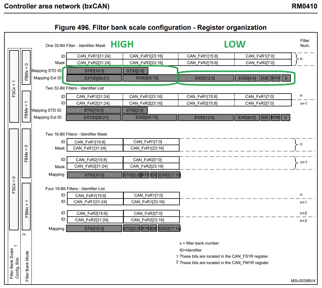

Once again I am struggling with CAN Filters for extended IDs using CAN2 on a STM32F765.
I have the ID 0x010100 and the filter should look like 0xXX0101XX where the X hex should be ignored.
One of my early approaches:
uint32_t filter_id = 0x010100;
uint32_t filter_mask = 0x1F0000FF;
CAN_FilterTypeDef can_addr_filter;
can_addr_filter.FilterActivation = CAN_FILTER_ENABLE;
can_addr_filter.FilterFIFOAssignment = CAN_FILTER_FIFO0;
can_addr_filter.FilterBank = 0;
can_addr_filter.SlaveStartFilterBank = 0;
can_addr_filter.FilterMode = CAN_FILTERMODE_IDMASK;
can_addr_filter.FilterScale = CAN_FILTERSCALE_32BIT;
can_addr_filter.FilterIdHigh = filter_id << 3; //Tried different shifts, didn't worked
can_addr_filter.FilterIdLow = 0;
can_addr_filter.FilterMaskIdHigh = filter_mask << 3; //Tried different shifts, didn't worked
can_addr_filter.FilterMaskIdHigh = 0;
if(HAL_CAN_ConfigFilter(&hcan2, &can_addr_filter) != HAL_OK)
 error_handler(CAN_HW_ERROR);
 return;
When sending a message to 0x010112 it works as expected
But when sending a message to 0x010013 it works against my expectations
Sending a message to 0x020112 does not work as expected.
Using different FilterIdHigh and FilterIdLow aswell different FilterMaskIdHigh and FilterMaskIdLow settings I can't get it working.
I probably made a *** mistake at one point...
I would be very grateful if someone could help me so that I can finally understand the CAN filter and find my error. Preferably as an explanation for a 5 year old so I don't have to ask again about filters.

For filter mask mode when you set a bit to 1 in the mask it means that this bit needs to match the ID, if 0, that bit is don't care.
So as I understood you want to receive the pattern in the form of 0xXX0101XX in Extended ID:
So you need to have the ID value set to 0x00010100 and mask value 0x00FFFF00.
If you AND bit wise both you will get something in the form of 0xXX0101XX.
Would suggest looking at the Picture/Diagram in the RM showing the relationship between the bits in the register and those on the wire you wish to identify. Randomly shifting won't get you to the answer, and as I recall the Extended ID spans more bits and probably not contiguous, as the two registers are 16-bit wide
The test is of the form (Bits in Register & FilterMask) == FilterID
Where the high order bit in the high order register is first over the wire
This is for the NORMAL 11-Bit ID (observe where the 5 bit shift comes from above)

Hello again,
thank you @mƎALLEm and @Tesla DeLorean for your quick responses.
I changed my filter mask to 0x00FFFF00 as mentioned and had a closer look at the diagram.
As I understand it now, this would be the correct way:
uint32_t filter_mask = 0x00FFFF00;
can_addr_filter.FilterIdHigh = (filter_id >> 13) & 0xFFFF;
can_addr_filter.FilterIdLow = ((filter_id & 0x1FFF) << 3) & 0xFFFF;
can_addr_filter.FilterMaskIdHigh = (filter_mask >> 13) & 0xFFFF;
can_addr_filter.FilterMaskIdLow = ((filter_mask & 0x1FFF) << 3) & 0xFFFF;
It works and I have understood the filters! Thanks again!
