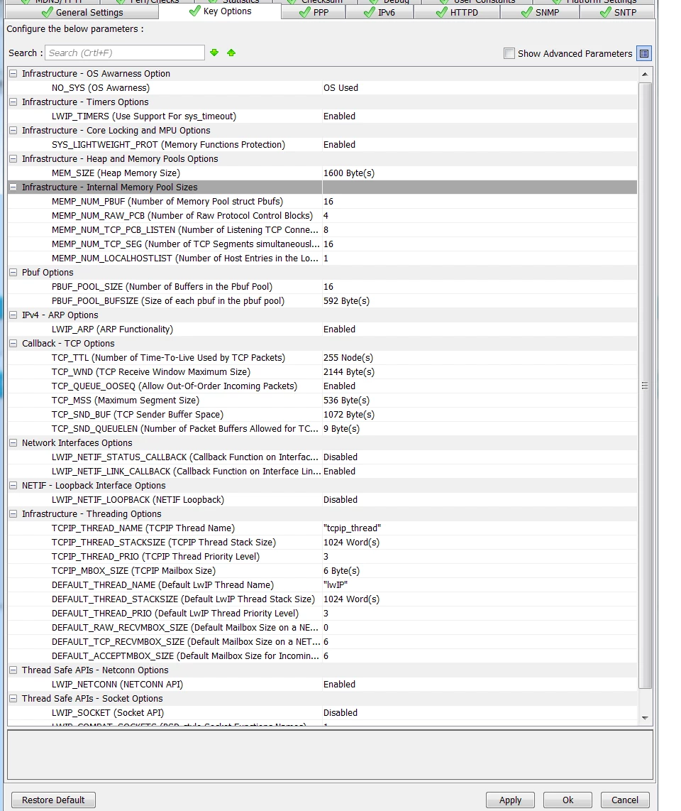

    As you suggested, will explore my alternatives, a different sequence order, spurious, re transmission, delay or timeout.
    I am adding a print screen of my cubeMX lwip key options tab.
    Can you please take a look?

    Joerg Wagner
    Senior III
    December 9, 2017
    Posted on December 09, 2017 at 00:11
    Hey ho Marina.
    You send 1024 Bytes (netconn_write) but you have a tiny segment size of 536 bytes? Pump it up.
    Some parameters should be tweaked to have a better performance.
    It's also a good idea to turn on LWIP_DEBUG to see what's going on with the traffic.
    Go to the Debug tab and turn on: LWIP_DBG_TYPES_ON, TCP_DEBUG, TCP_OUTPUT_DEBUG, TCPIP_DEBUG.
    Turn on LWIP_Stats (Tab Statistics) to get a feeling for the memory pool buffers (pbuf).
    Take a look at the maximum usage, like a peak, if you need more.
    Do not forget providing enough space on the FreeRTOS Heap as well.
    If you do not use a printf for output you can simply run your code in debug mode, wait for some actions pause it
    and in the Expressions tab analyse the variable lwip_stats. It's a structure with all the statistic information.
    Another good tool for you would be Systemview from Segger for profiling the execution over the time.
    Greetings,  Joerg
    PS: I do not set the LWIP settings in CubeMX anymore, I modify lwiptopts.h later.
