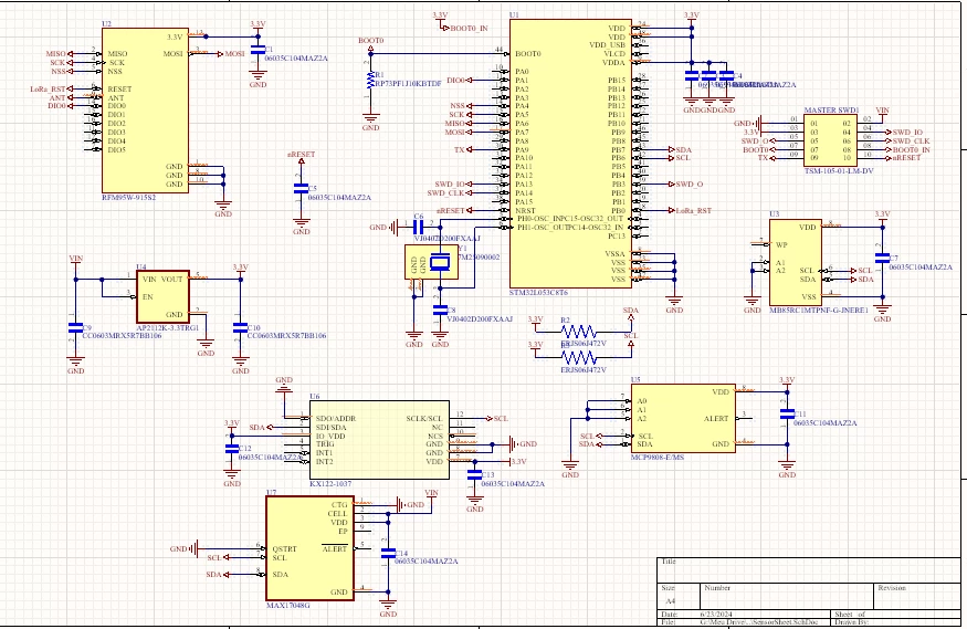

I have a system of sensors connected to an STM32 chip, all working via I2C and 3.3V.
I've created interface libraries for my sensors, specifically the temperature and accelerometer ones. However, when I read the values measured by the sensors, I came across a strange result.
Here's a printout of the serial communication:

As you can see, the acceleration and temperature values are all wrong. They should be double values.

So, the problem is that these codes are in a private GitHub repository, and as I couldn't use the tags I preferred to put everything in a folder so that the question doesn't lack information. I apologize for that.
As for compatibility, I don't think that's the problem. I've tried removing the accelerometer and testing only temperature, and the other way around too.
I think there really is a problem with my libraries. This is the first time I've programmed a library for an i2c device from scratch.
