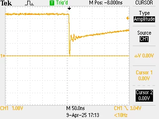

  We found a serious problem in the behavior of the memory bus pins during reset.
Our design uses an STM32H743I CPU and non-volatile MRAM/FRAM memory connected via a bus. We use the FMC controller to access the memory, the bus pins are set up, and everything works. We have pull-up resistors on the nE[x] (chip select), nOE (output enable) and nWE (write enable) pins so that the correct levels are present on the memory inputs when the CPU starts. The problem occurs during a reset triggered, for example, by a watchdog or a reset button, when a negative glitch appears on these pins, causing an unwanted write to memory.
We have the same HW design equipped with STM32743I rev. Y (older than rev. V), where this problem is also manifested to a lesser extent and pull-up resistors compensate for it, but with rev. V the manifestation is significant.
The following are measurements on rev. Y and rev. V. We used the FMC_SRAM example from STM32Cube_FW_H7_V1.12.0, so we believe the FMC is initialized correctly.

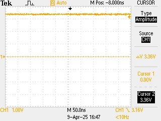

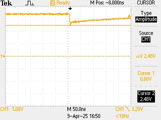

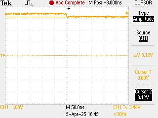

Our HW with STM32H743I rev. Y (Similar measurements were observed on the STM32H743I-EVAL board with rev. Y)

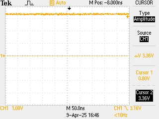

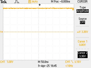

PD5 – nEW – glitch from 3.36V to 3.12V
PD7 – FMC_nE1 – no glitch, stable 3.36V
PG9 – FMC_nE2 – no glitch, stable 3.36V
PG10 – FMC_nE3 – no glitch, stable 3.36V
PG12 – FMC_nE4 – glitch from 3.36V to 2.48V

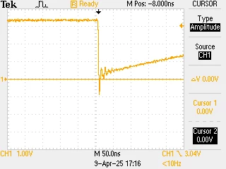

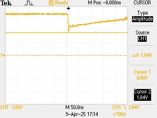

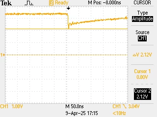

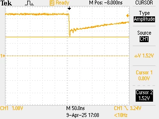

Our HW with STM32H743I rev. V
PD5 – nEW – glitch from 3.36V to 0V
PD7 – FMC_nE1 – glitch from 3.36V to 1.84V
PG9 – FMC_nE2 – glitch from 3.36V to 2.12V
PG10 – FMC_nE3 – glitch from 3.36V to 1.52V
PG12 – FMC_nE4 – glitch from 3.36V to 0V
From the documentation: “During and just after reset, the alternate functions are not active and most of the I/O ports are configured in analog mode“. So it looks like when the I/O pin is transitioning to the default state, the output is set to 0 for a while.
I would like to ask ST to investigate the problem, provide a SW workaround and mention the problem in the Errata document.

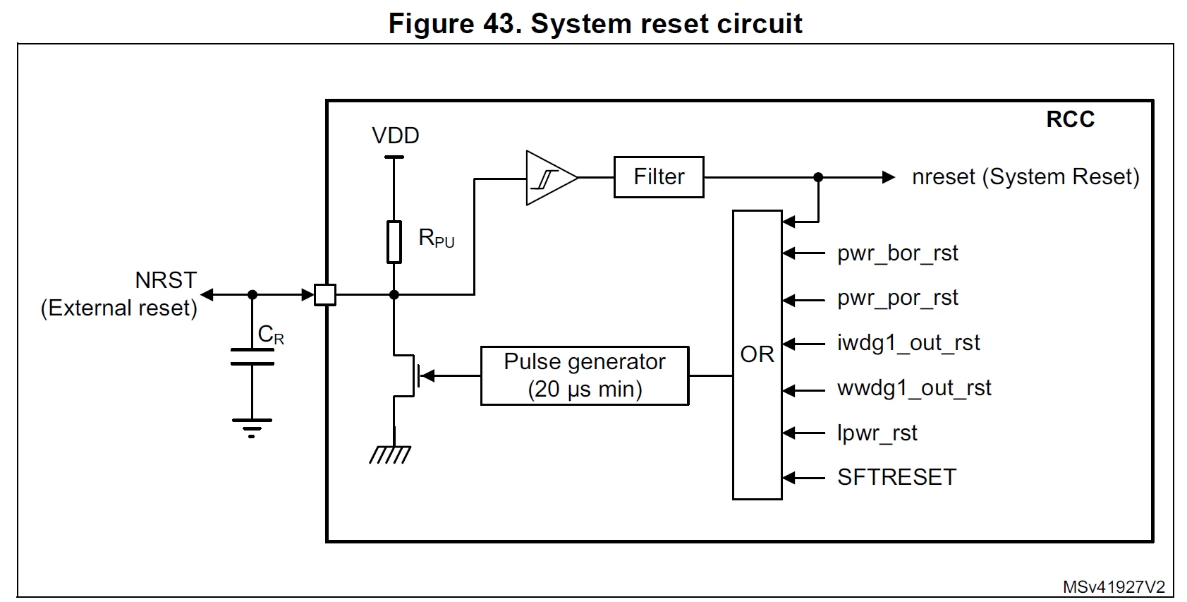

Pavel A.
May 1, 2025
This chip has the nWE pin not for nothing. What if you link it to NRST so that write automatically gets disabled in unfortunate moments?
EngyCZ
EngyCZAuthor
May 5, 2025
Hi @Pavel A.
We measured the sequence of nWE and nRST pins and the nRST signal is activated much later, after the problems on the pins I described.
waclawek.jan
May 5, 2025
Hi @EngyCZ ,
This is intriguing, as it defeats the very purpose of the nRST output signal (as a way to convey the internal reset signal to other circuitry). Here you are talking about the case when nRST occurs from "inside" the mcu, such as watchdog, I presume.
Would you have waveforms taken for this issue, can you please post them.
Also, what exactly is connected to nRST?
Sorry I have no comment relevant to your main issue.
Jan

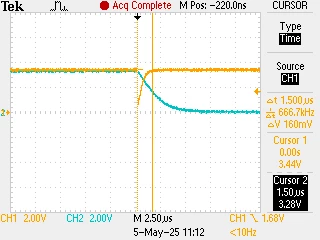

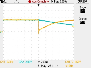

EngyCZ
EngyCZAuthor
May 5, 2025
Hi @waclawek.jan & @Pavel A.

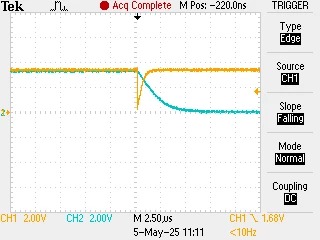

OK, a small correction. The voltage on the nRST pin starts to decrease simultaneously with the nWE glitch. However, it is not as fast as nWE probably because of the capacity 100nF on the input.
Thus, in the "digital" world, nRST switches to 0 later than nWE.
nWE - Yellow, nRST - Blue
Pavel A.
May 5, 2025
Which pin is nWE, PD5?  how it is configured (strength/speed, PU/PD) ?
waclawek.jan
May 5, 2025
Thanks for the results with nRST. I now see that we are down at the nanoseconds realm.
If you are willing to experiment further, let's make a similar assumption then what @Bassett.David made above, i.e. that some portions of the whole circuitry reset faster than GPIO_MODER into Analog: let's assume that GPIO_AFR[] resets faster, disconnecting the pin driver from FMC itself (I presume that FMC wouldn't drive those pins to 0 under reset, an assumption which may be false, too). Now most of those pins don't have an explicit setting for GPIO_AFR[]=0, but I've seen cases where even if this was the case, some of the other signal sources was in fact connected.
So my experiment would be, to set given pins - while still being AF in GPIO_MODER - to GPIO_AFR[] = 0; and then try to experiment with the peripherals which are at the same pin, whether any of them would drive the output pin high. If it would, then I'd try to revert the pin to FMC while retaining that setting of that "other" peripheral, and invoke the reset.
I know it's a slim chance this would work; but let's be honest, what's the chance ST will provide a workaround here, or, more precisely, given the nature of the problem, what's the chance there *is* any sane workaround here.
