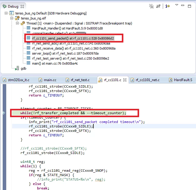

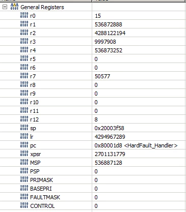

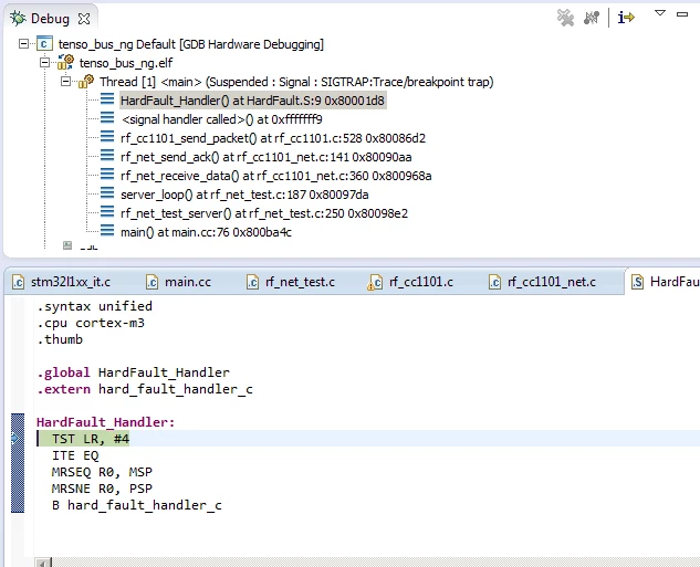

    Registers when Hard Fault occurred
    Eclipse stack trace

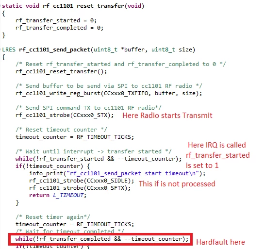

    And the code when HardFault occured - wait cycle, just decrementing uint32_t and wainting for modification of volatile integer from IRQ handler.

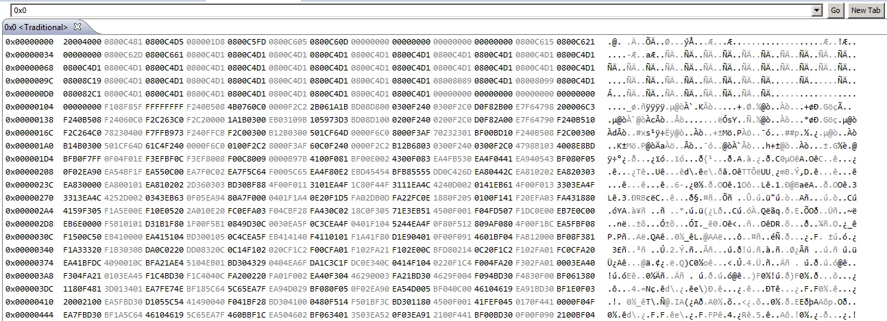

    Your Hard Fault handler hex output suggests it's dumping the vector table (at zero), and not register or stack content.
    PSP = 0 ??
    It would be helpful if you display the other register list in hex, you look at the faulting instructions in assembler, and you hex dump the stack.
    If it really goes into process mode, as perhaps a result of a corrupted stack return from interrupt, and the stack is pointing at zero, you can surely expect it to fault.
    So figure out the scope of your stack (0x20004000 .. 0x20003F58), see how deep it really gets, look at what you have as local/auto allocations within normal code, and under interrupt. Fill the stack with a known marker so you can observe the low water mark.

    Registers when Hard fault occurred:
    R0 -      0x7a
    R1 -      0x200007bb
    R2 -      0
    R3 -      0x20004014
    R4 -      0x800c439
    R5-       0x848d
    R6-       0x80001d8
    R7-       0x85b5
    R8-       0
    R9-       0
    R10-     0
    R11-     0
    R12-     0
    SP-      0x20003f40
    LR-       0xfffffff9
    PC-      0x80001d8
    XPSR-  0x41000003
    MSP-   0x20003f40
    PSP-          0
    PRIMASK-  0
    BASEPRI-   0
    FAULTMASK 0
    CONTROL   0
    PSP is 0 during the whole program execution.

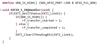

    The IRQ handler is very simple.
    The problem occurs in routine for sending packets.
    I've traced the all instructions in debugger up to the place where Hard fault occured.
    No suspicious local variables (only int result codes etc).
    No memory operations like memcpy on stack variables.

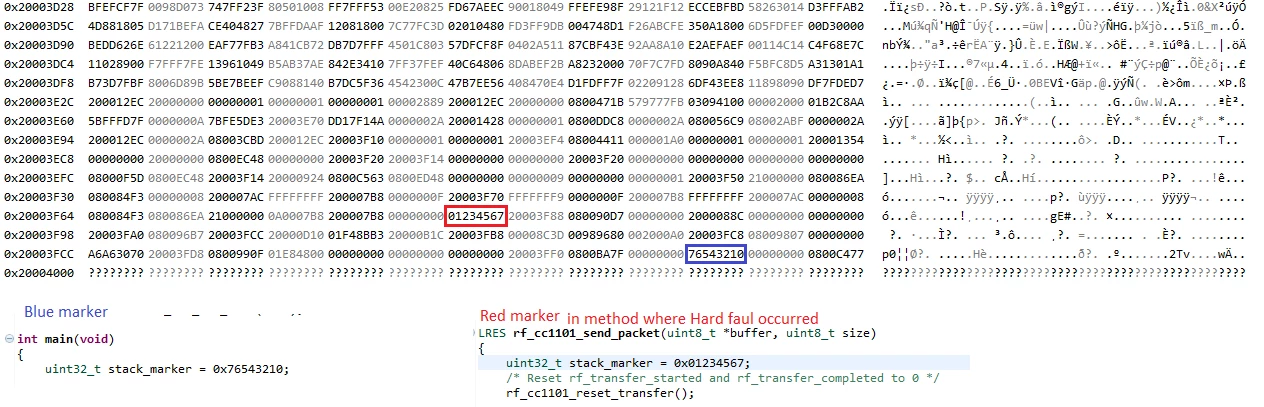

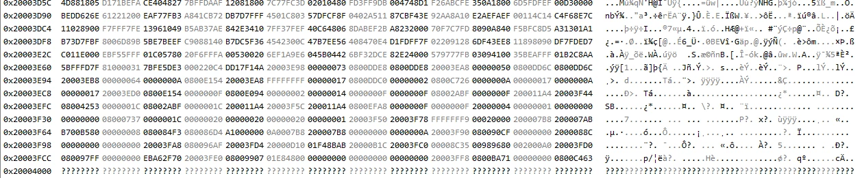

    Stack dump after Hard fault
    Another run with stack markers
    Tesla DeLorean
    Guru
    January 22, 2014
    Posted on January 22, 2014 at 16:58
    I can't particularly understand why the Hard Fault routine was passed 0, here with an LR entry of 0xFFFFFFF9 it pulls the stack from MSP
    Looking at the stack frame as is, we have
    0x20 r0
    0x20 r1
    1 r2
    0x20003F50 r3
    0x20003F78 r12
    0xFFFFFFF9 lr
    0x00020000 pc
    So it looks to be coming from some other interrupt or fault (LR), the PC is invalid (EVEN)
    Your code itself looks innocuous, even without the disassembly, or knowing if the variables are volatile. The issue is elsewhere.
    You should examine all your interrupt vector entries, looking for the unfilled ones, or ones containing 0x20000
    You should consider what other interrupts or DMA you have enabled, or could be occurring.
    You want to double check your clock settings, flash wait state and prefetch configuration.
    You want to see if there is some voltage spike, or short, or GPIO connected with the RF sending/completing.
    There is no other IRQ handler enabled, only SysTick_Handler is running.

    There is no Interrupt vector entry pointing to address
    0x20000
