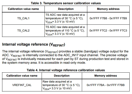

Strange ST factory calibration on STM32f042k6 (ADC)
I'm trying to use temperature sensor and the internal voltage reference (VREFINT) of the STM32f042k6.
Here is the extract form the datasheet (page 19/117) :
When I measure these values, I don't have the same values than ST.
For example, let's watch the internal voltage reference :
  • VREFINT_CAL (factory calibration) is 1529 (12 bits ADC value)
  • if I measure it myself with the DAC, I get 1470 (12 bits ADC value).
The difference is too high and I can't use theses data. Maybe the problem come from a bad configuration ?
If I set the STM32 voltage to 3.2 V, it is more accurate, but, in ST datasheet, the calbiration was done with 3.3V...
My hardware :
  • only one power supply for Vdd and Vdda : 3.29 V (checked with multimeter)
  • temperature : 18°C
  • ADC config : 12 bits, max sampling time (239.5 cycles)
  • STM32 frequency : 48Mhz
  • I'm using HAL library
Thanks for reading,
Best regards,
Valentin

Did you calibrate the ADC before use?

You were right, I thought the ADC calibration was done when initializing the ADC with HAL library, but we need to calibrate with the following code
HAL_ADCEx_Calibration_Start(&hadc);
Thank you for your help,
Best regards,
Valentin
